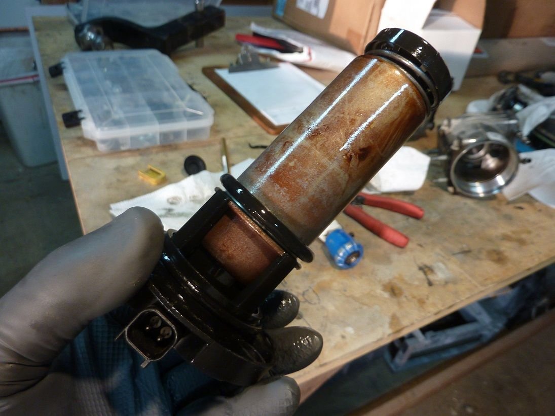

I think I found the culprit, old fuel and a failing fuel pump as a result.

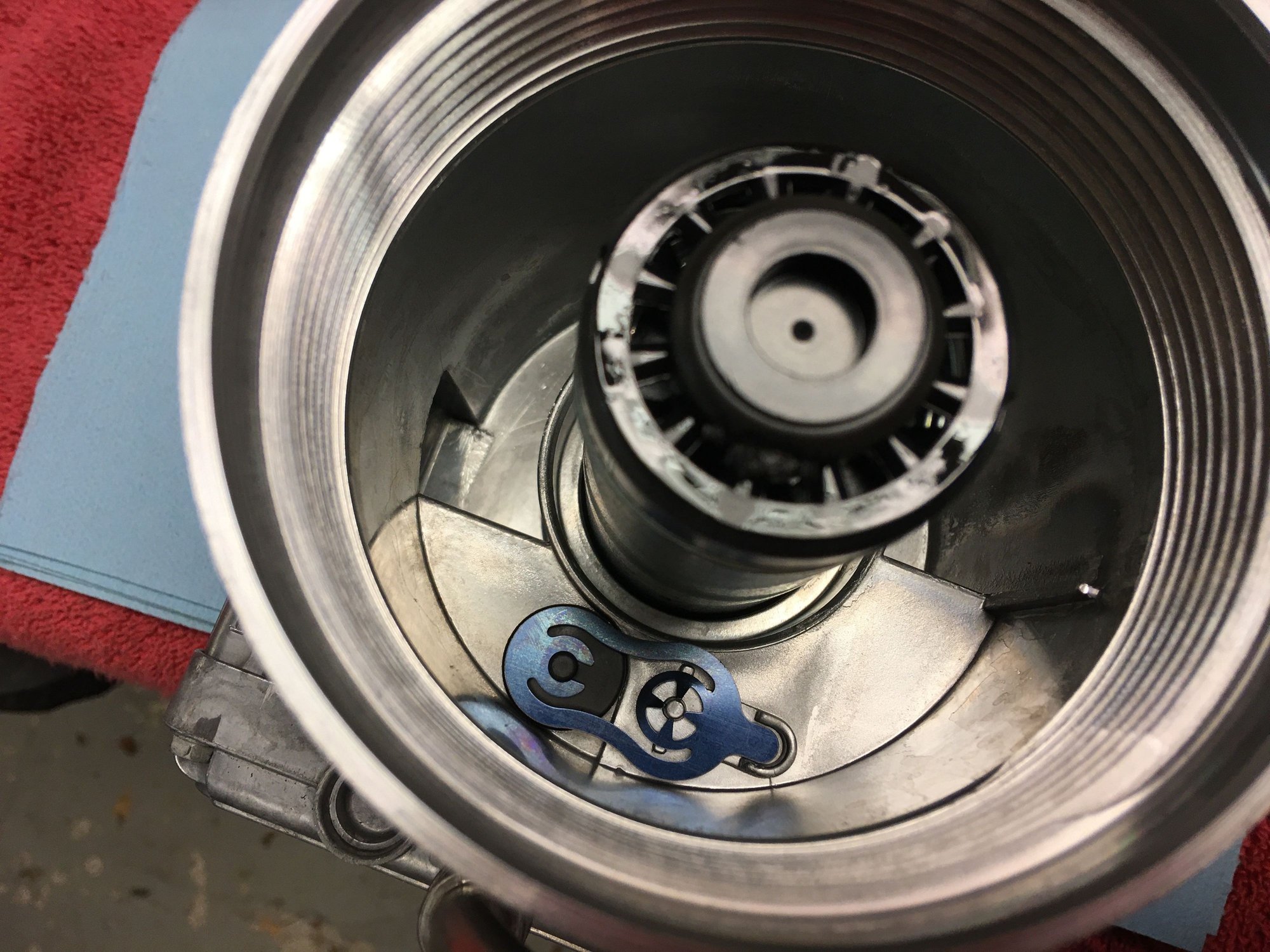

The HFCM that came on the truck is cleaner than the one I put on the truck. The rusty sheet metal check valve retainer is supposed to have a blue oxide finish.

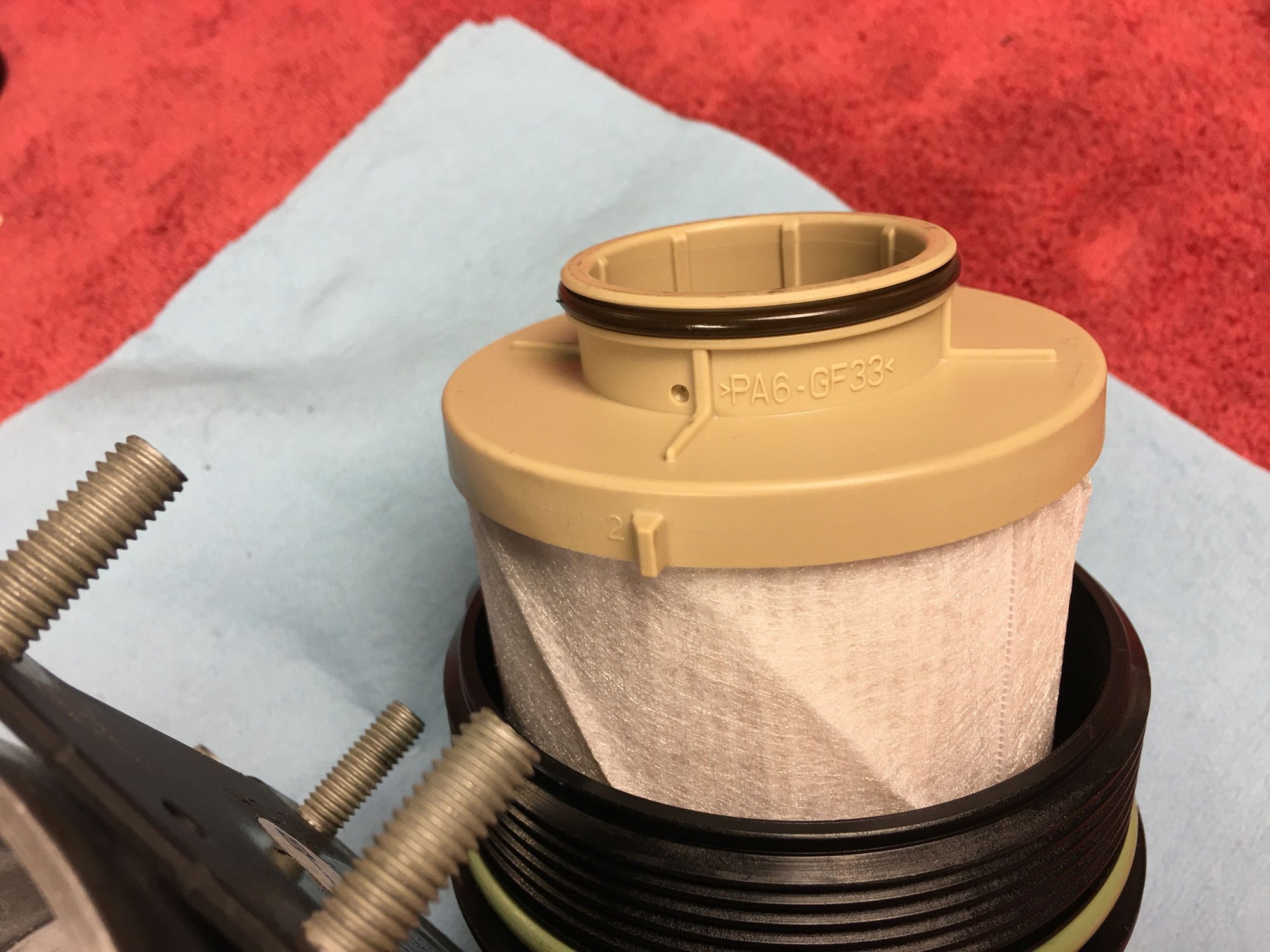

That piqued my curiosity, I pulled the filter from the Racor/Carter/NAPA HFCM I got from RockAuto.
Right now past conversations about 6.4L/6.7L fuel system pump failures due to water and rust are resurfacing.
