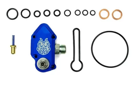

Lots of price gougers out there selling blue spring kits. Here's one for $90.75. Doesn't even include free shipping:
https://puredieselpower.com/ford/03-...o-housing.html
And lots of sellers of cheap imitation kits on Amazon also. $23.99 takes this dandy home:
Amazon Amazon
At least you get some cool factor with this Sinister kit for the $99.00, though it looks to be missing some parts:
https://www.dieselpowerproducts.com/...werstroke.aspx
I think I'll stick with White Bear Lake for this buy. $56.06 and it gives me a reason to update my oil level dipstick.
https://parts.autonationfordwhitebea...it-3c3z9t517ag
