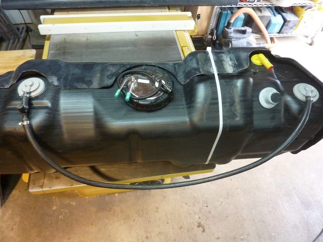

Here's the tank ready to go. Had to take about 5" off the fuel line between the balance tube lugs, but it was easier to get the tank back up than I thought it would be. Having the front of the bed raised helped a lot I'm sure.

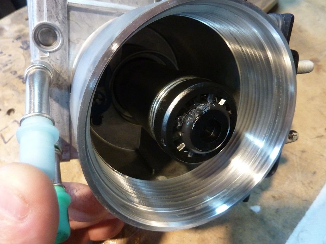

I got my 30% off Napa/Carter HFCM this morning. Glad I pulled the filter to inspect...
I went to a different store that had one for replacement and the same o-ring was damaged too. I got "lucky" at the third store. I've never had damage to this o-ring since I've owned the truck; four years and two HFCMs. I've always installed the fuel filter by first plugging it into the cap and then cranking it down. This is now twice in two days. The first was a Delphi pump that I bought to use with the old HFCM. I installed it and then pulled it to see if I could return it when I found out about the Napa deal, and the o-ring was as bad as the one pictured above. I was still able to return it as the cap wasn't mounted to the pump body very well. Maybe that was a case of misalignment due to the cap. Maybe Napa's deal is just poor assembly on the production line. I hate to think that something has changed with the parts and this is going to be a problem for everyone going forward. I know I'll be installing the filter first followed by the cap from now on.
Having had the opportunity to inspect three of the Napa/Carter HFCMs, I can say I am not impressed with their quality control. The first two had clean castings, the one I brought home not so much. Also, the filter cap on the third one has a bunch of little dents in it like it was getting knocked around in shipping on its way to assembly. I am also not impressed with Delphi at the moment. Not only did the pump have its issues, but the foot on the sender unit was warped and it was mounted too high on the uptake tube. I may install a sump just so I don't have to worry about the crappy foot anymore.

It's typical of OE suppliers to send the out of spec units to the aftermarket. Usually, it's the typical issues you've seen of the O-ring. My unit has a little flash on the O-ring, I'll address that. I've never seen one with a chewed O-ring like that.

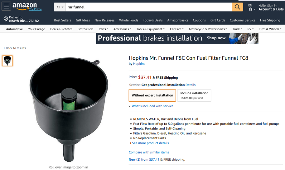

I saw this at Napa and it piqued my interest for prefiltering my stored fuel. Racor also has a version of it. I can't find any info about how many gallons it's good for.
Gotta love Amazon's installation price, btw...
