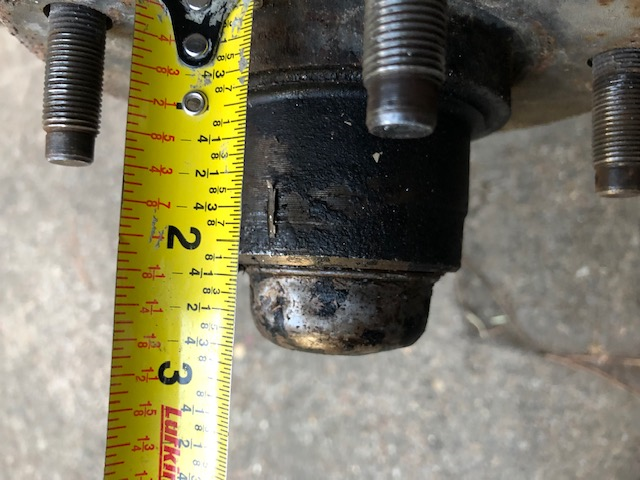

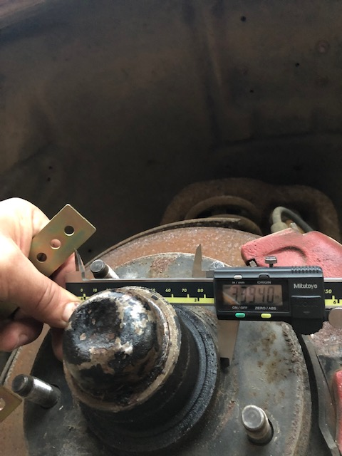

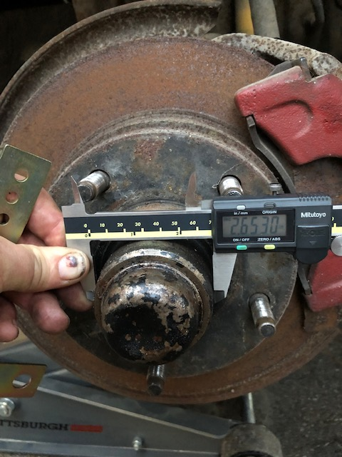

I have searched previous posts and haven't found the information I'm seeking....I have my heart set on American Racing Torq Thrust wheels. I want to plus size and the dealer recommends 18x9 wheels with 0 offset and 255/55R18 tires. The issue lies in the hub size. The American Racing wheels will only clear hubs which are shorter that 58MM (2.3") with a diameter less than 74MM (2.9").
In the attached picture the you can see the hub length is approximately 2.234" without the grease cap which is under the 2.3" required by the manufacturer. First question is, does the hub length include the grease cap which would bring the length to 2.75"? Also hub diameter shows to be 2.65" but if you measure the step at the rotor it's 3.5" which is out of spec for the wheels. So my second question is, does the hub diameter include the step on the rotor? Third question, has anyone ran larger wheels without lift and was there clearance issues?

Could the wheel fit if you used a wheel spacer of say a 1/4"?
I have a car I need to run a spacer for my 14" TT to clear the duel piston calipers on the front.
Just make sure you get lug nut that fit with that spacer you may use.

Thanks Dave, I believe that would probably work!

Zero offset is considered centerline of the wheel. Positive offset would place more wheel to the inside of the vehicle. Negative offset would place more of the wheel to the street side. Offset has much to do with the design of the wheel. The way the spokes are designed for esthetic reasons. So offset for wheels will change for vehicles to allow for clearance issues. In my particular circumstance zero offset was recommended. My issue lies in the center cap. Ford hubs are possibly to large for this type of wheel. As others have mentioned I believe a spacer would solve the issue.
