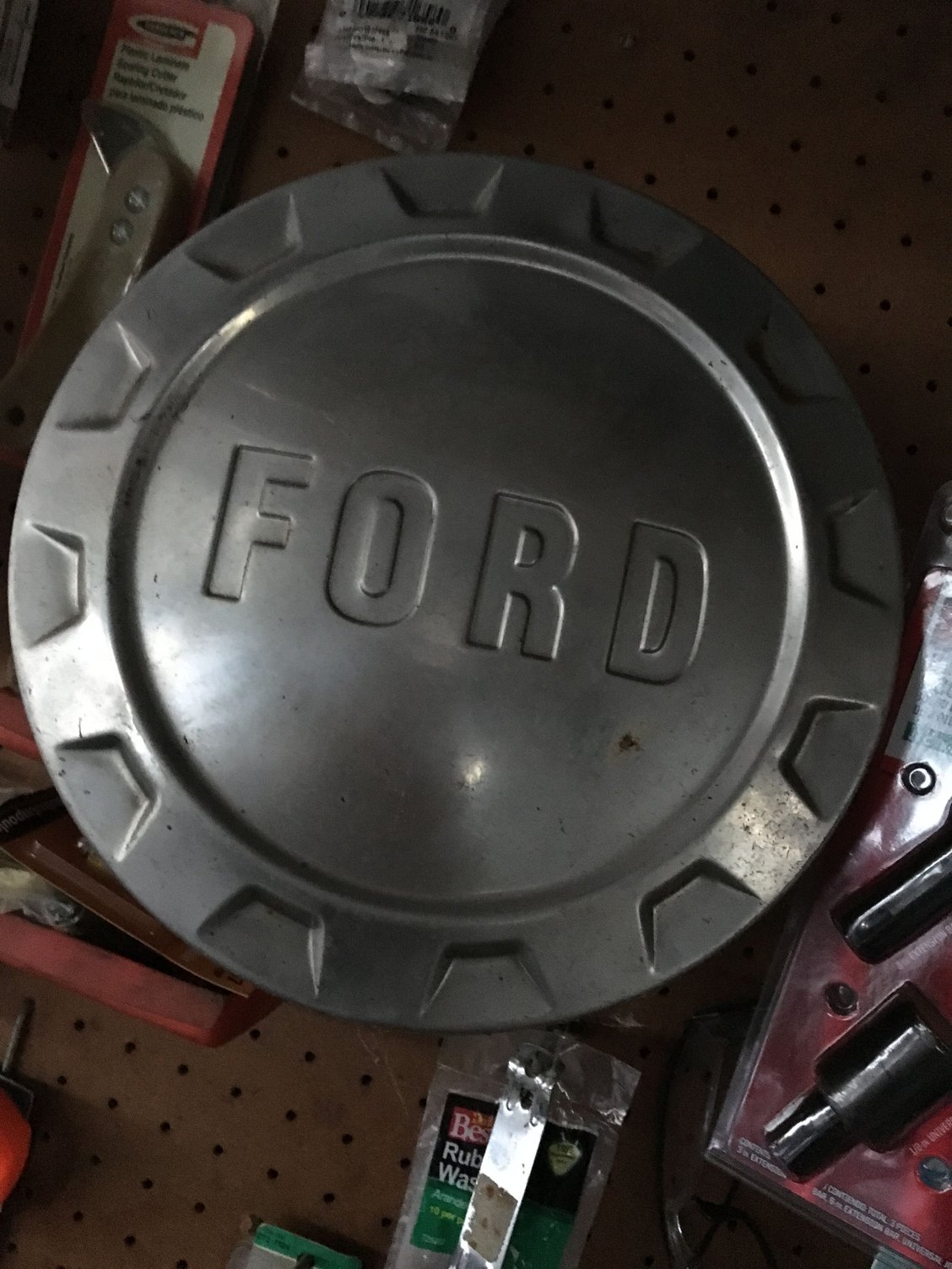

I am working on my '66 F250 camper special 2WD. I'm thinking about purchasing a set of 16" steel wheels from Vintiques that match the 8x6.5 lug pattern. I want to paint them the same color as the truck and put the dog dish hub caps on for an original look. My question is how do I know these or any other wheels would work for the hub caps?. I only have one original hub cap, so I'll need to acquire some more of the original or find a replacement.

Do you have a picture of the hub cap you have now?

The wheel vintiques 8 lug wheels are '67 up style "outies". You would not be able to use the original "bottle cap" dog dish hub caps.

Is that stainless steel? If so, even more rare than the painted variety.

Those wheels are the old Kelsey Hayes 43552 16" x 6" - 8 on 6.5 pattern.
B9TZ-1015-A was one of the Ford part number, I believe.
Very similar to the split rim style that came on some of these trucks originally, but these are a one piece wheel. They have the innie nubs for mounting the caps and the caps do fit well since it is the same mounting as the originals.
You probably already know this but the F250 caps are a bit larger diameter than the F100 caps, by about an inch or so.
Oddly, the Master Parts Catalog doesn't even list a part number for these larger stainless steel variety but they do for the smaller type 1 - 9 1/2" diameter - stainless of C3TZ-1130-A and they reproduce those smaller ones.
Here's the same one piece wheel with the 10 1/2" white with red lettering Type 1 caps - I scarfed these off of an F350. I also have the same in the argent with red lettering.
