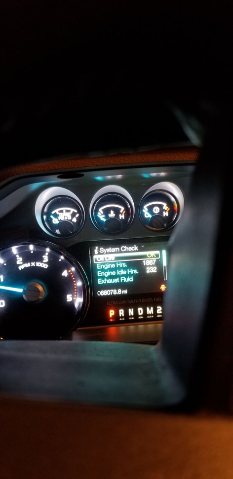

Here is the lastest pic I have as a comparison. Yes yours are not too bad
Don't listen to anything he posts about his unicorn truck. You will not find another one like it!

updated unicorn picture for your benefit
freshly taken just a few minutes ago
