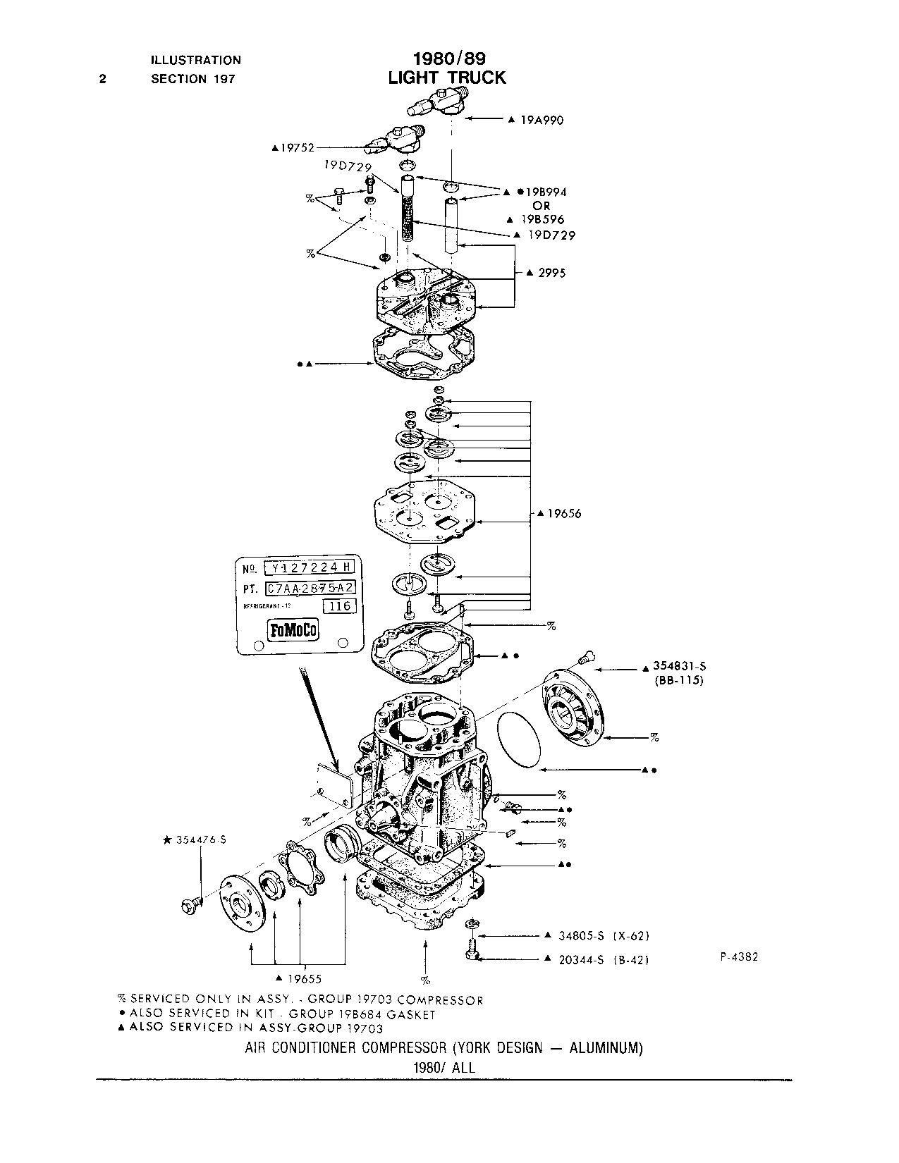

One type of hoses connect directly to the compressor, the other type connect to service valves located on the compressor.
Once you know the type, let me know and I'll search for them. I've done this every day for members since 11/4/2006.
There are several different types of compressors. Here's a pic of the York type, the service valves are shown as 19752 and 19A990
The hoses that connect directly to the compressor thread onto orifices, there are no valves.
