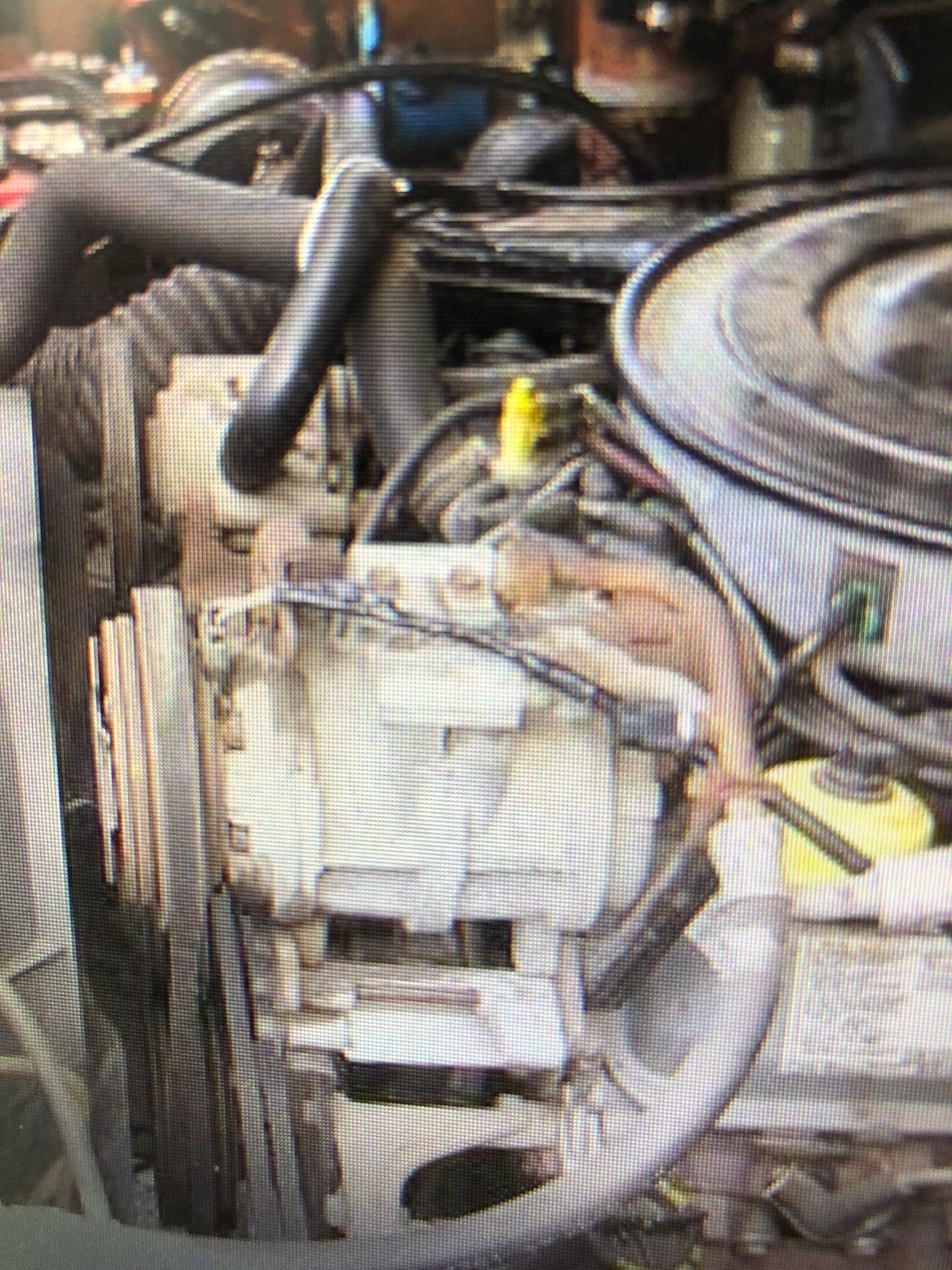

What exactly is the compressor ran off of on the accessory drive? The only pulley that seems to line up is directly off the water pump. Although I doubt the compressor is ONLY ran off the water pump, maybe crank, wp, and ac, which means I’ll have to reroute some other belts....

I see what your saying for the manifold to compressor fitting, I was kinda hoping that would come with it, but then again, my compressor looks nothing like the pictures you posted!

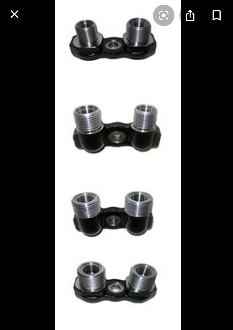

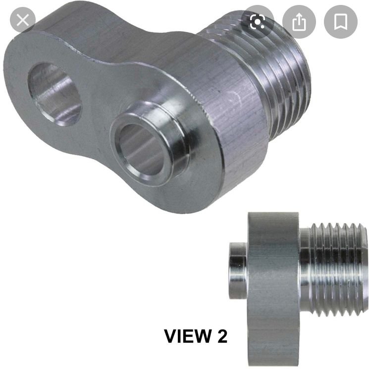

I'll call a couple of those places this morning, is there any reason I can’t find a generic sanden fitting? I seen two styles on a google search.
Dual port style, don’t think that works though with bolt pattern.
Single port, which makes 4 ports on my compressor?

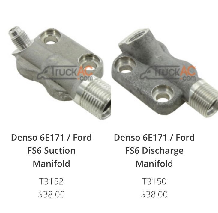

I’ve only seen 1 picture of the manifolds I need and it was a small picture, looks like it had 2 bolt holes and 2 port plugs into the compressor with 1 outlet. And there were 2 of those on the compressor.
Other than that picture, I’ve never seen another! Maybe a oem part number would help to try to cross reference?

The only picture I’ve seen that I believe will work

Will those work?
