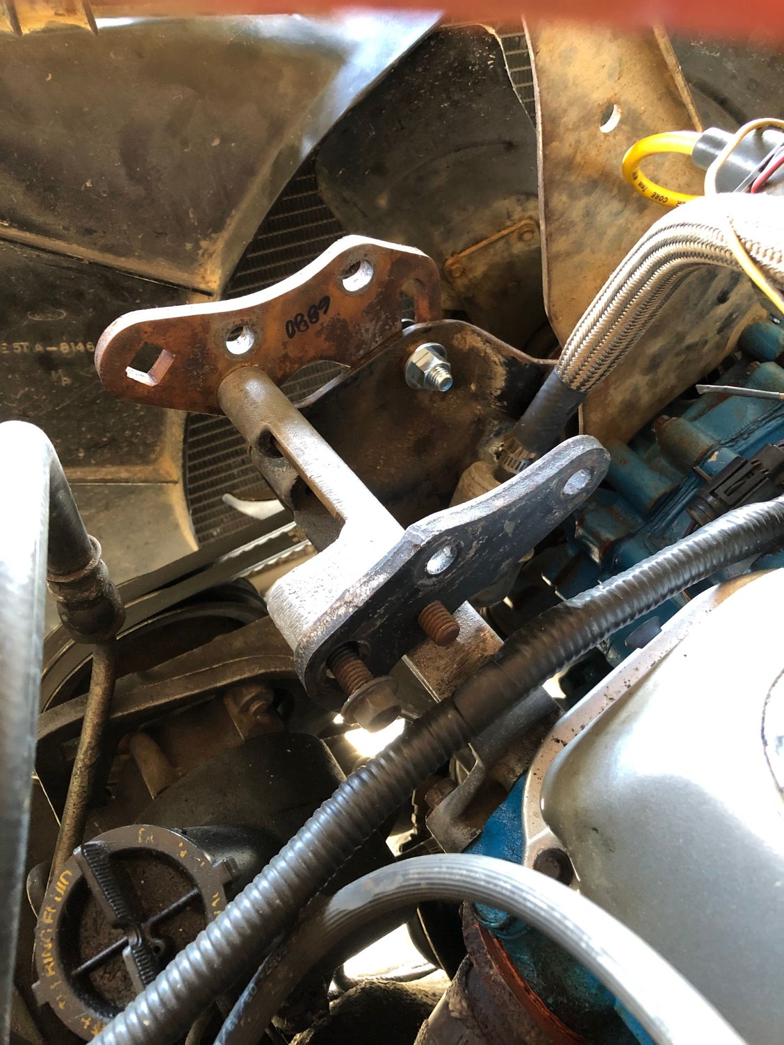

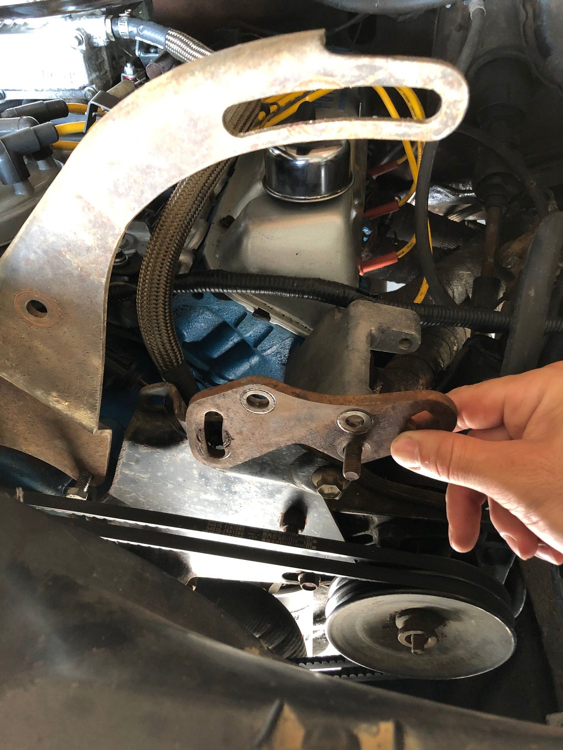

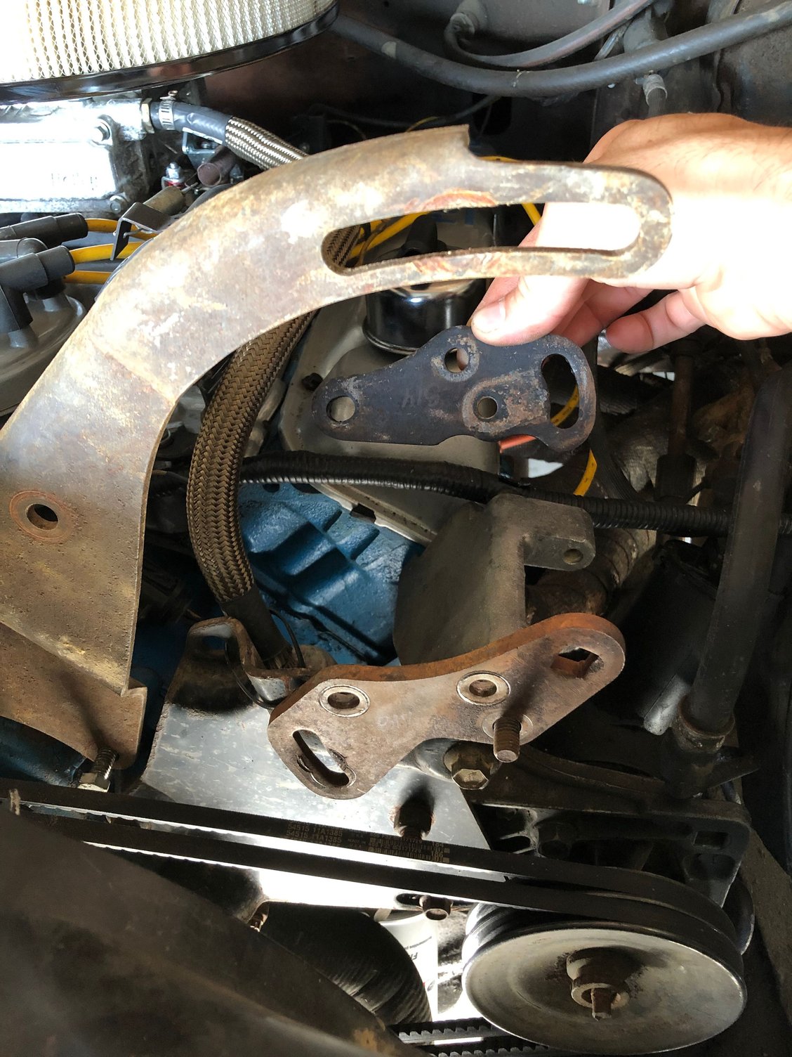

Got the brackets in today, using the diagram on Gary’s website, but it’s a little hard to read. After playing around with the long adjuster bracket, I got it bolted to the water pump. I got the front adjuster bracket where it should be (i think) not sure if there a long bolt with a nut that goes through the power steering bracket and holds it on like the picture. And I’m not really sure how the rear bracket goes on.
The three brackets I got today.
The long arm installed, the front adjuster where it looks like it goes?
No idea where that goes except for the bolt that goes in the compressor and that’s the general orientation.

I saw the 2 different styles, and I’m ignorant to these systems, so I’ll have to do research. Regardless of whether it was factory or dealer installed, I’m wondering how many differences over the entire system there were? And because I’m starting from scratch again, I can essentially build whatever style I want.

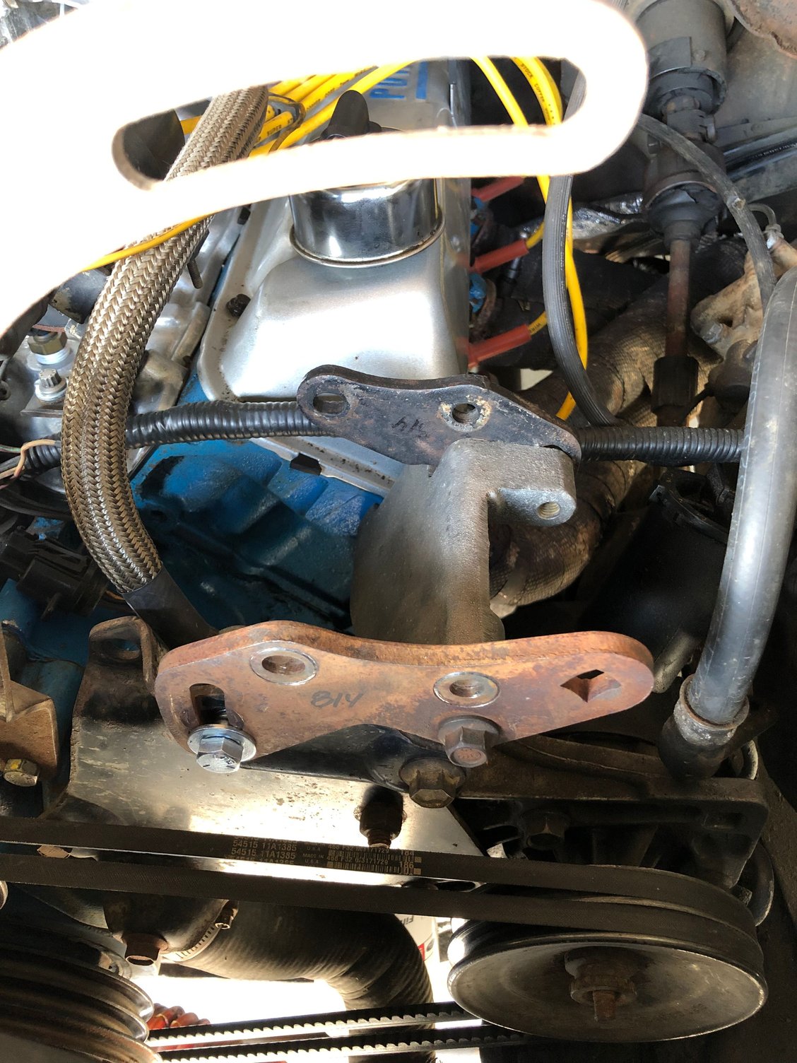

It kinda seems like this is where they go, I should get compressor tomorrow, will see how everythIng bolts up.

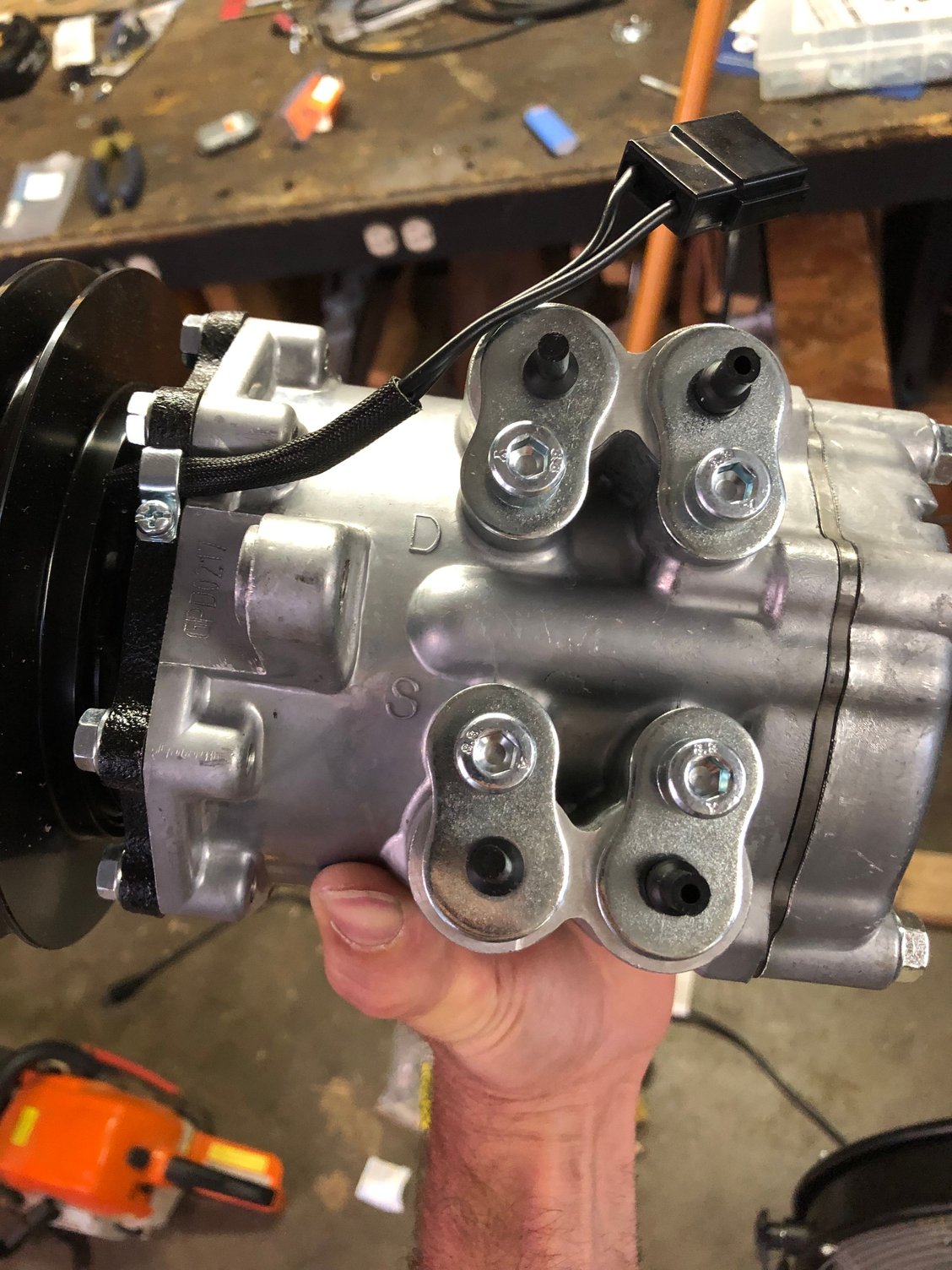

The rub is going to be the fittings on the compressor. You will have to figure out what type of fittings the compressor has, and if you need the service valves to transition to the service valve type hoses, or the direct fit hoses. This may not be easy to figure out.

Here is one with service valves, looks like it has 2 bolt flanges to mount to the compressor.
Old Oct 3, 2019 | 06:01 PM
Franklin2's Avatar
Franklin2
Joined: Jan 2001
Posts: 56,984
Likes: 2,738
From: Virginia
Even though this compressor has one service valve, looks like both the other line and the one with the service valve screw in directly to the compressor.

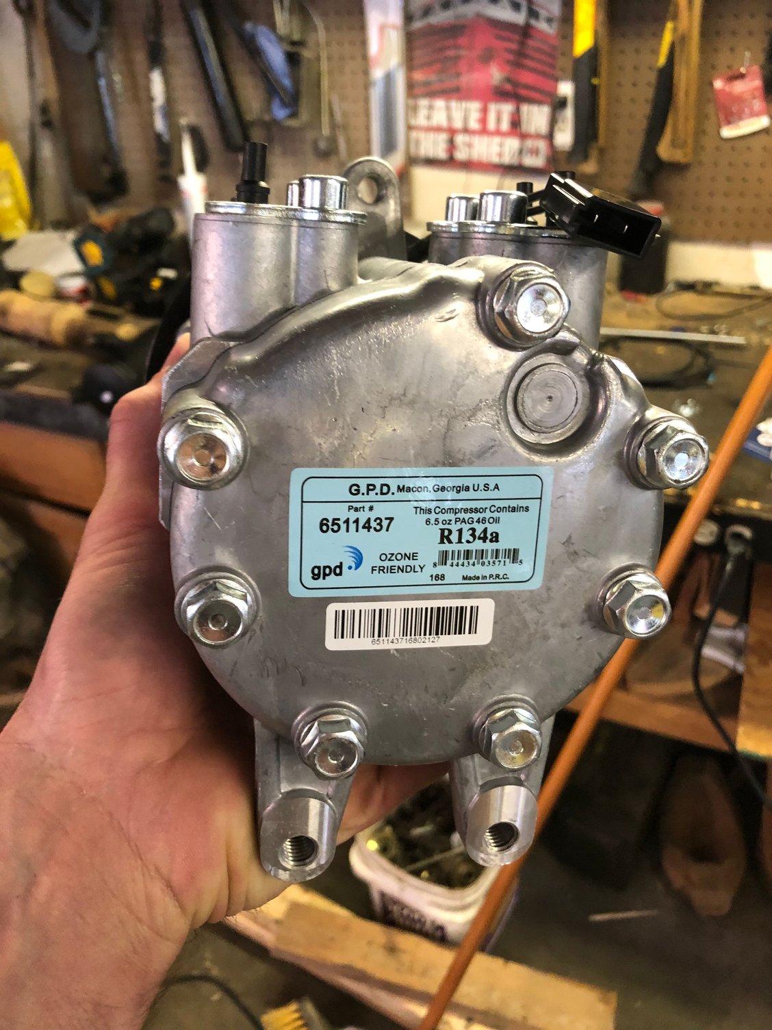

Big help so far! Thanks! As I promised, this is what I got from rockauto yesterday, so what “style” is it and does everything look compatible?
Back of the compressor
Top showing the ports
