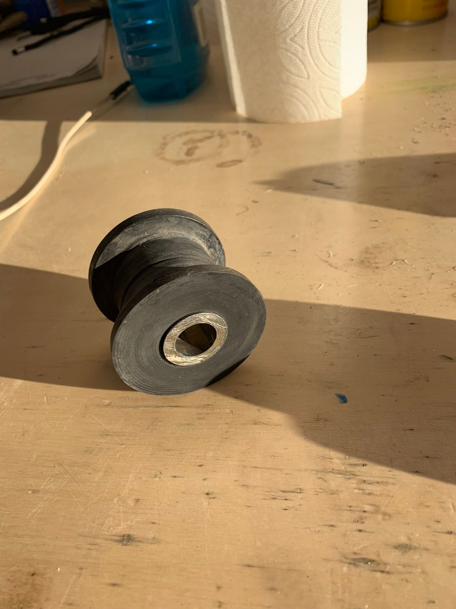

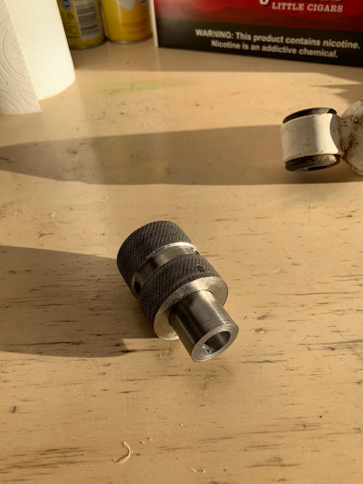

To give you a couple of pictures for a visual. On my Jeep I have a 37-12.5-17 Goodyear MT/R’s with Staun internal beadlocks, making for a heavy tire and wheel assembly. I had built up all components with heavy duty parts......tie rod, tie rod ends, drag ling, ball joints, tracbar, etc. Everything.
After a while ......yup.....death wobble. I was under it many times. Looking for just what it could possibly be. Road force balance all tires. Install good steering stabilizer, etc. Adjusting toe in, caster, tire pressures, etc. I found that by running at least 42 PSI in the front tires, there was no DW most of the time, but it would still occur at certain speeds if a bump was hit just right. Study things some more. On the heavy duty tracbar, there is a heim joint where it attaches to the axle, and there was a pliable rubber bushing where it attaches to the frame.
When I was under the rig, having someone work the steering wheel, I could not see any movement there at all. But, since I have a minimal understanding of DW, and minimal understanding of Newton’s third law as per @17 Oaks stated above, I thought there is a possibility of something I can not see.
When it comes to dealing with DW, the obvious is not always obvious. So I went to work and built a solid bushing to take the place of the above rubber bushing.
Before installing this bushing, I made sure the mounting holes in the frame were round (not egged out), rounded up a 9/16” grade 8 bolt, fit the bolt snugly into the inner bushing, fit the outer bushing into the tracbar and re-installed the tracbar. Went out and went for a drive......NO MORE DW!!!!!!!!!!!
After all this was done, NOW I went ahead and install a FOX steering stabilizer to help it drive even better. I have driven across cattle guards, hit bumps, done everything I can to get it to wobble and it is all good.
I have showed you all this to demonstrate that it could be just one component that was sub-standard when it left the factory, but it takes somebody to understand what to look for to figure it out. Maybe, in my ordeal, the compound used to make the bushing was not up to standard, I don’t know.
It could be a certain combination of little things. These are all man made, and subject to flaws. Sorry you got one that is flawed.
PS. Just so I am not mis-understood in the picture of the solid bushing, the inner is slid half way out for a better visual.
