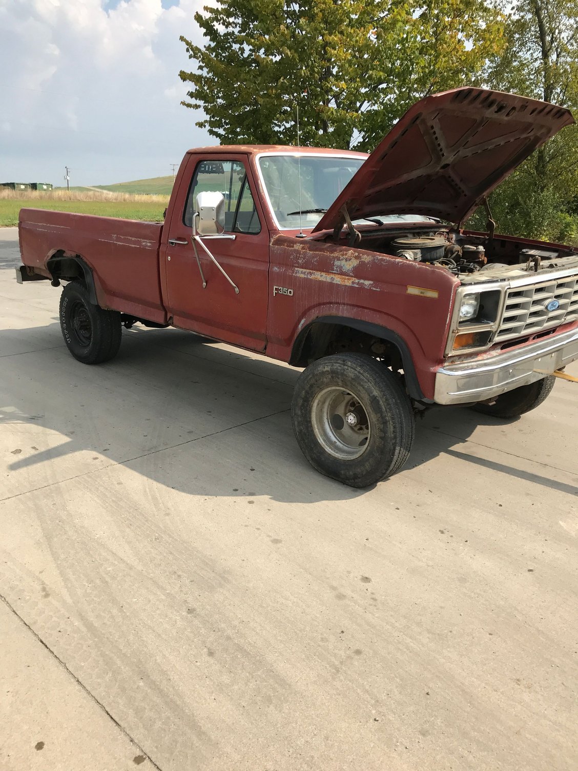

Here’s the priject
Thanks for the boost! I’ll let you know what I find out!
