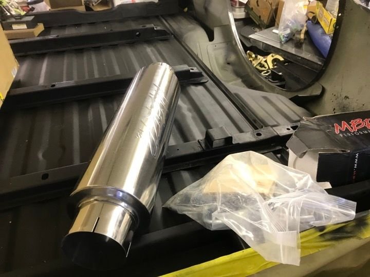

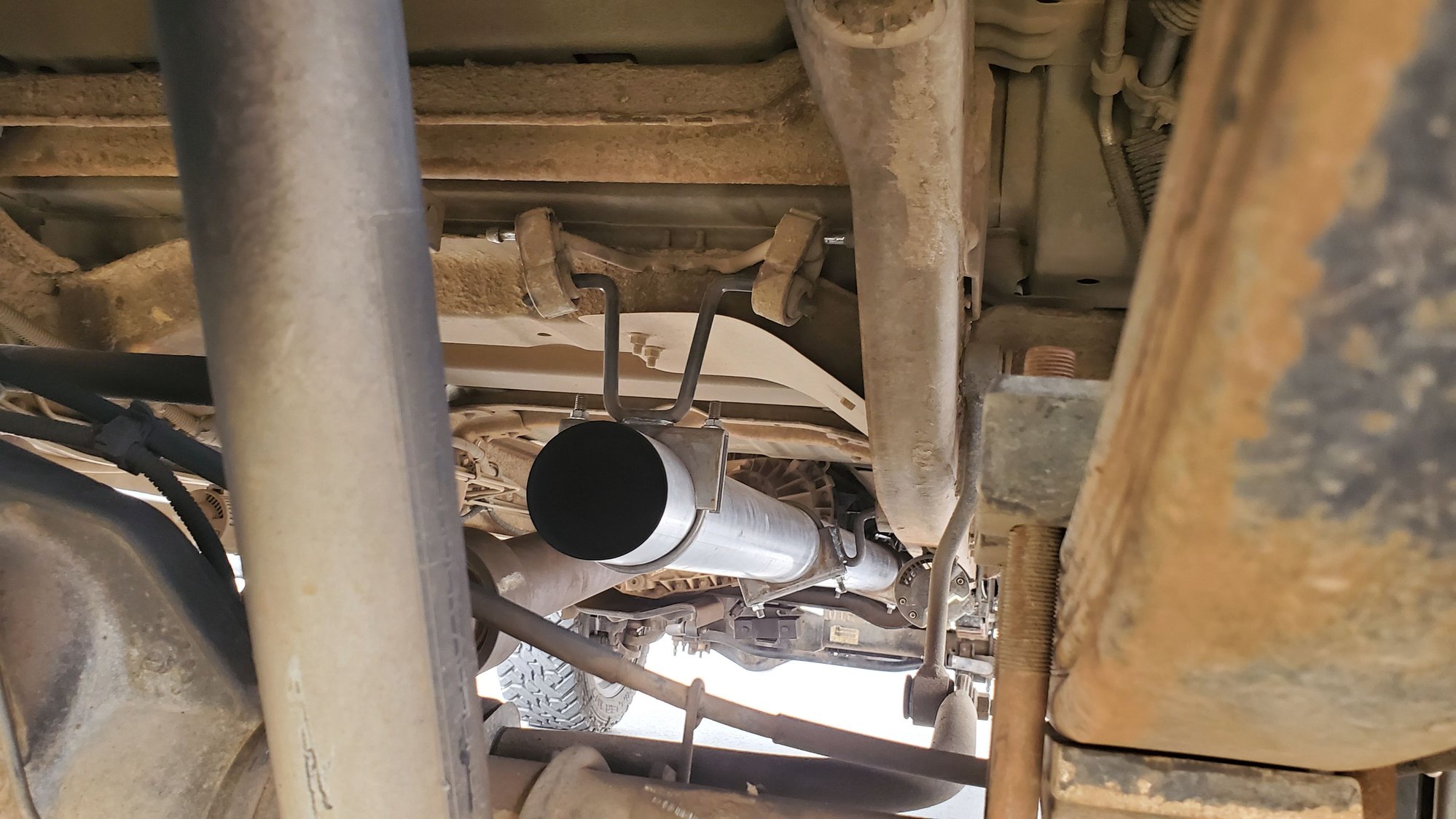

Ok here are some photos from the kit. There was a good when they sent the kit to me as they sent the Ex one and not the LBCC.
This first photo is the one that you would be looking if you put the Kat back in. I think you can still use it with the test pipe.
These photos are the correct kit installed. I will get the short idle video uploaded to Youtube and post that.
