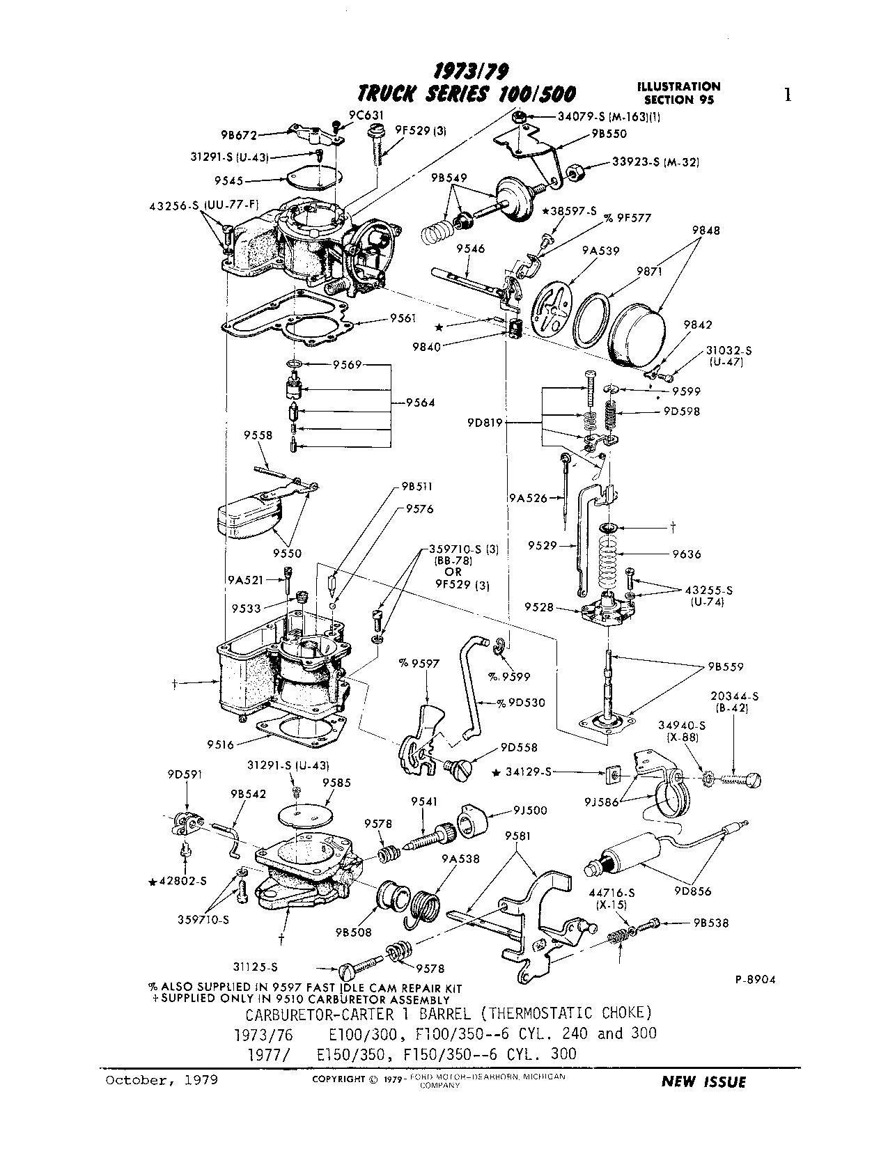

77 f250 with carter 1bbl carb
gor a reman one and hooked it up. New fuel filter in line but didn’t replace the part that the line attaches to that screws to the front bowl.
It was running a lot smoother than the other carb, then it started to leak near the base on the front under the bowl where the linkage is.
I took it apart art to see if any gaskets were torn and it looked fine.
It it almost looks like it filled the float bowl up and leaked down the shaft the goes to that linkage.
Any ideas?

I like what you suggested there with float height. If the foot is too high and it lets fuel go down that shaft maybe that’s what I’m seeing. I didn’t do any adjustments when I threw it on but will now and see if I can get that lined out
thanks for the diagram from numbers dummy and for your suggestion
