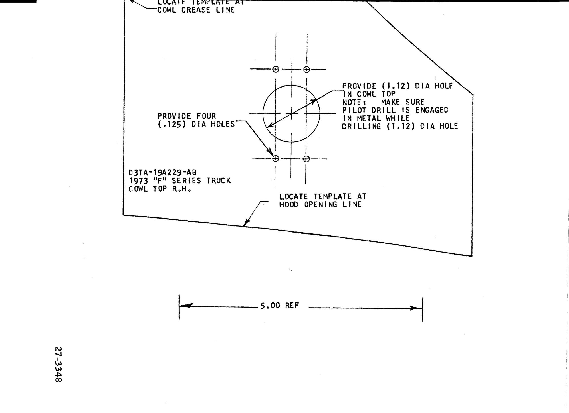

This is the template that Ford included with a new antenna.

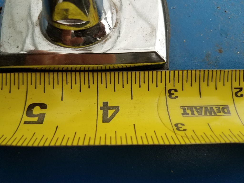

I just took antenna location measurements on google earth. Measurements are same as before.
