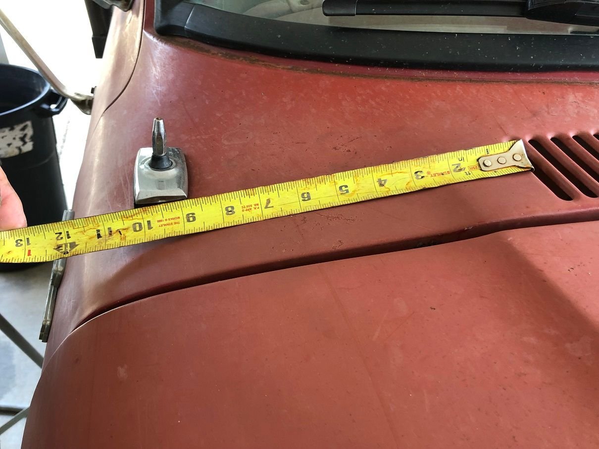

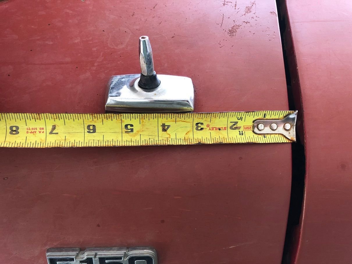

I have a 76 F350 that never had a radio and I want to install one. I have a ford antenna with the rectangular base. My problem is I am not sure where to drill a hole in the cowl. Could someone give me the measurement from the front of the rectangular antenna base forward to the edge of the cowl(towards the hood), and the measurement from the side of the rectangular base down the side of the truck(towards the fender) to the edge of the cowl ? With those two measurements I should be able to figure it out. Thanks!

Hang in there, I am sure someone that owns a tape measure can get you that. I have a tape measure....but I am 7,459 miles from my truck. I am searching my pic stash for ya and this is all I can find so far.

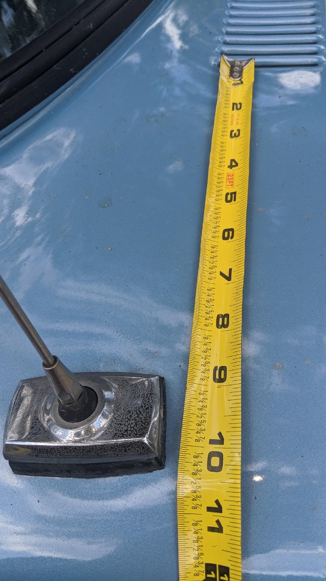

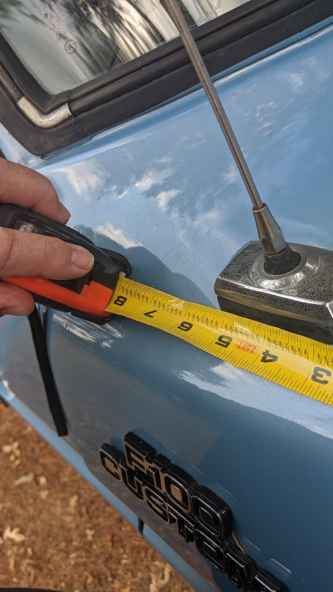

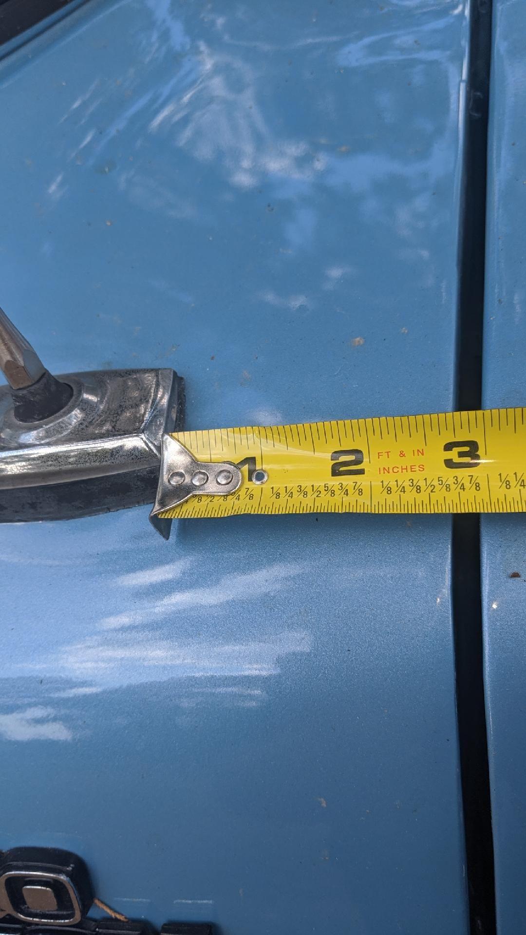

Here's what I got sorry I'm not an artist lol. So from the front of the rectangular base to the hood is 1". From the right side of the base (as if you're sitting in the drivers seat) is 2.25 inches to where the Cowl bends down. I used this measurement because eyeballing is hard on this curve and I had an actual body line to follow. The easier measurement is to measure from the left side of the base. This measurement is 8" from the very last air slit in the the cowl. If you need clarification on any of it I'll just take a picture and draw on it that way.

THANK YOU!!!! I was having trouble eyeballing it from pics of trucks. Nobody ever takes a picture of their antenna.

I used an antenna off a 94 F150 and the 1" and 8" measurements. It went on great, but if you stand directly in front of the truck, the antenna leans slightly outward. Maybe the base was cut a little differently on the 94????? It's not hardly noticeable, so I'm not going to worry about it.
