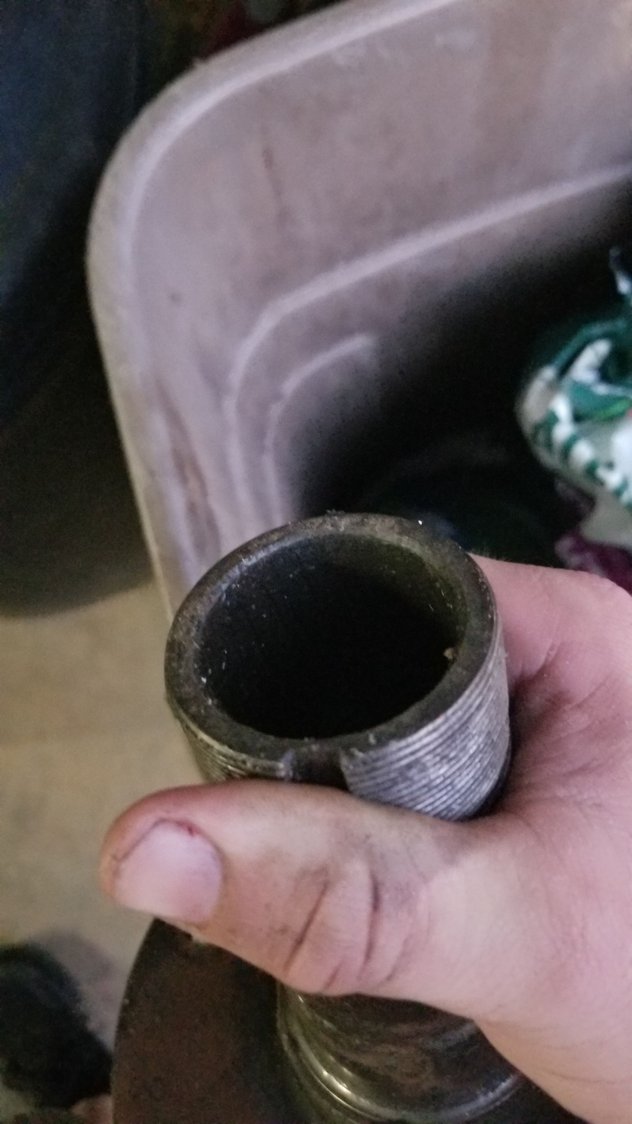

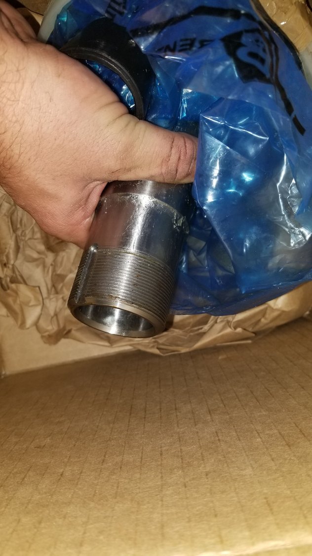

Got a problem that I hope someone else has had and can help.
Have a Dana 60 out of a 95 F350 with milemarker locking-hubs that are less than a year old. I am in the middle of replacing spindles, bearings, and seals in the hub.
My new Yukon spindles have a bevel at the end that my stock spindles did not have. Because of the bevel, I'm having difficulty reinstalling the milemarker hubs. There is a piece that will not go past the bevel to thread on to the spindle.
Is this just an incompatibility problem or is there possibly a defect.

Finally found the name for that part. Its a 3in1 locking spindle nut and not part of the milemarker hubs

Those are used on the rear not front...did they come off the front?

If those are what appears to be the rear nuts then keep in mind the rear sterling has both left and right handed nuts so maybe that is your problem. I like that style and use them on lots of different axles. I have 2 right handed ones on my Dana 80 now

Sorry for taking so long to reply. That part did come off the front axle of my truck, but I went ahead and bought the correct spindle nuts for the front and everything went back together correctly.

Wow, yeah. I was sitting here going "those are rear spindle lockers...."
I can see the thought behind it, but the way the front loads vs the rear, that would just wreck bearings as the rear spindle nuts have a bit of play and not dealing with the same forces as the front.
