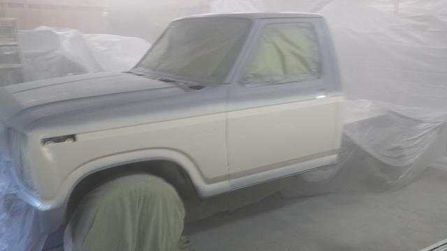

Acrylic Enamel single stage with hardener done last weekend.
Still have the bed to do yet.

Dave, it looks great from here! I have a question on the two-tone paint. Did you spray the center light color first and red later, or vice-versa? Any tips about masking for it? I'm going to be painting mine someday but I've never done two colors before. Thanks!

Sorry for getting back late.
When I learned the trade and red / white colors the white went down first then the red.
This was because of bleed thru, if white went over the red it would turn pinkish so with that in mind I did the white first.
I have also been told it makes no difference but was not going to take that chance.
I them used 1/8" stripping tape to tape the lines for the 2 different colors and used masking paper to cover the white before I sprayed the red.
Sorry for the bad picture
Here you can see the paper still on the rear fenders of my flare side.
