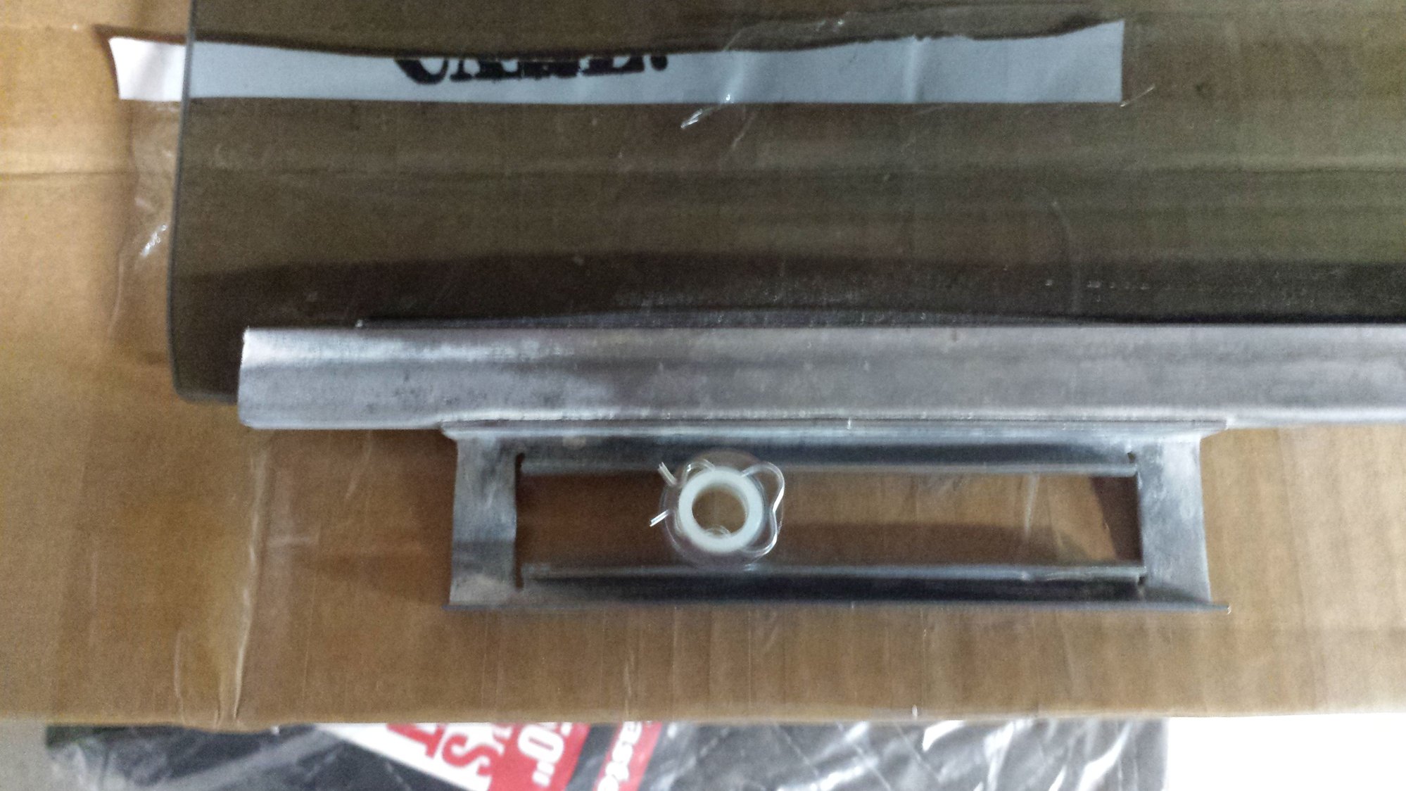

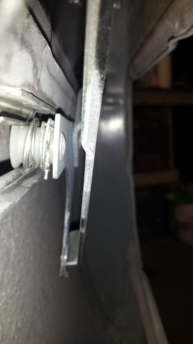

Like Abe said the rollers need to be in the channels first. Then with the regulator & the window in the down position. Push the regulator pins into the rollers. The rollers will slide in from the side of the channels, but are a little hard to do because of the tension on the roller spring.
I put this roller on while the window was in the door. A real PIA and it looks like its not in the channel correctly. I'll have to try again.

Thanks, av! A picture is worth a thousand words.

I just put a new regulator in my RH door yesterday & will probably put the LH door together today. So I had everything out available to take pics.
