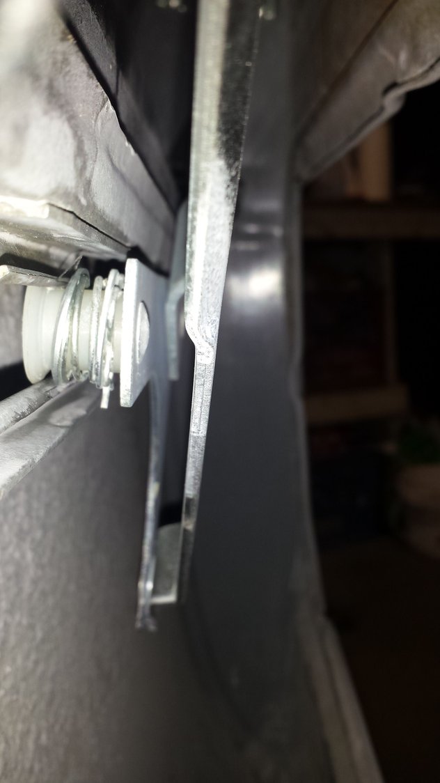

I ended up buying reproduction regulators from Mid- Fifty for $74 ea.
They look to be decent quality, the main body is a little thinner than the originals, but the rest looks to be the same.
Regulator Roy had some NOS regulators for $125 ea plus shipping. I just didn't want to spend that much, so I gambled and bought the repros.
They are better than my used ones but still a little clunky when rolling the windows up. Not so bad when rolling down.
I used a spray on dry lube on all the moving parts & gears. I have all new channels & anti-rattle strips. And used the nylon rollers. Which are a little smaller diameter than the original metal ones.
because of the smaller diameter they don't fit the channel like the originals.
So these will have to do. I probably should have went with power windows but I guess I'm just weird and wanted to keep the manual windows.

Maybe you could swap over the larger metal rollers to replace the smaller nylon ones?
