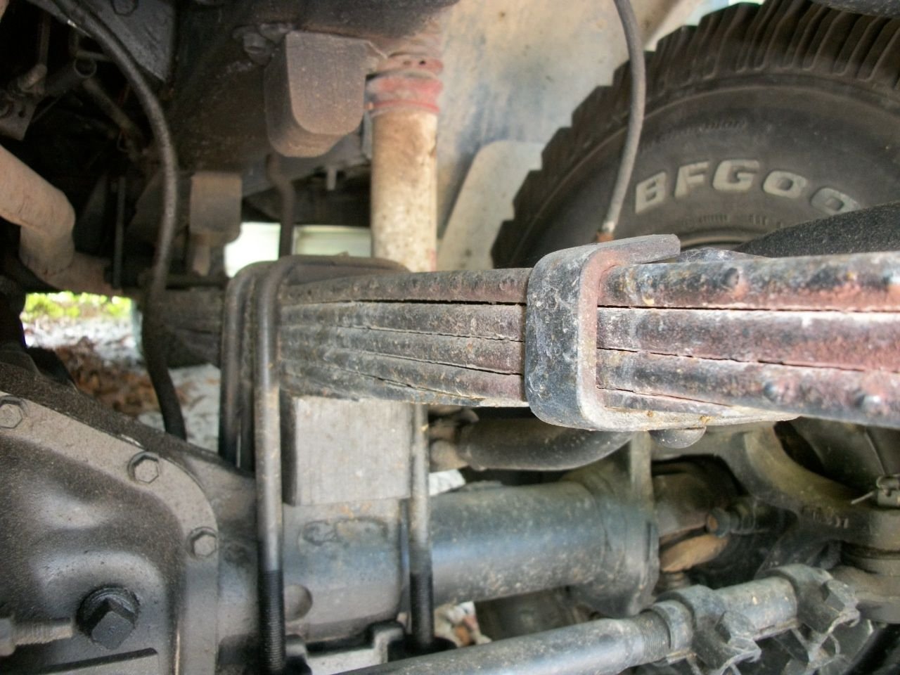

Well since you already have them, it is just a lot of work for the possibility to find out that they are worn out. Are they 6 leafs? They might look nice and curved now, wait until the weight of the truck comes on as the jack goes down. Make sure you have your fine thread u bolts clean clean clean. And you still might have to cut them off. Having a new set on hand, sure makes it nice. Also are you going to replace the used HB leaf spring bushings with some Energy Suspension ones? Here is how ol blue was with its USED HB leafs...and blocks. Blockhead PO. Last pic is right after the Rough Country's were hung.

77&79F250 those springs really flattened out.

Flattened out...almost like re-curved the wrong direction. When I took them off they even sort of went back sort of curved. I got a deal on the Rough Country lift and am regretting it now. I have a measurable difference between the two sides when it came right off the jack stands. Cheap and easy is not always the best route.
