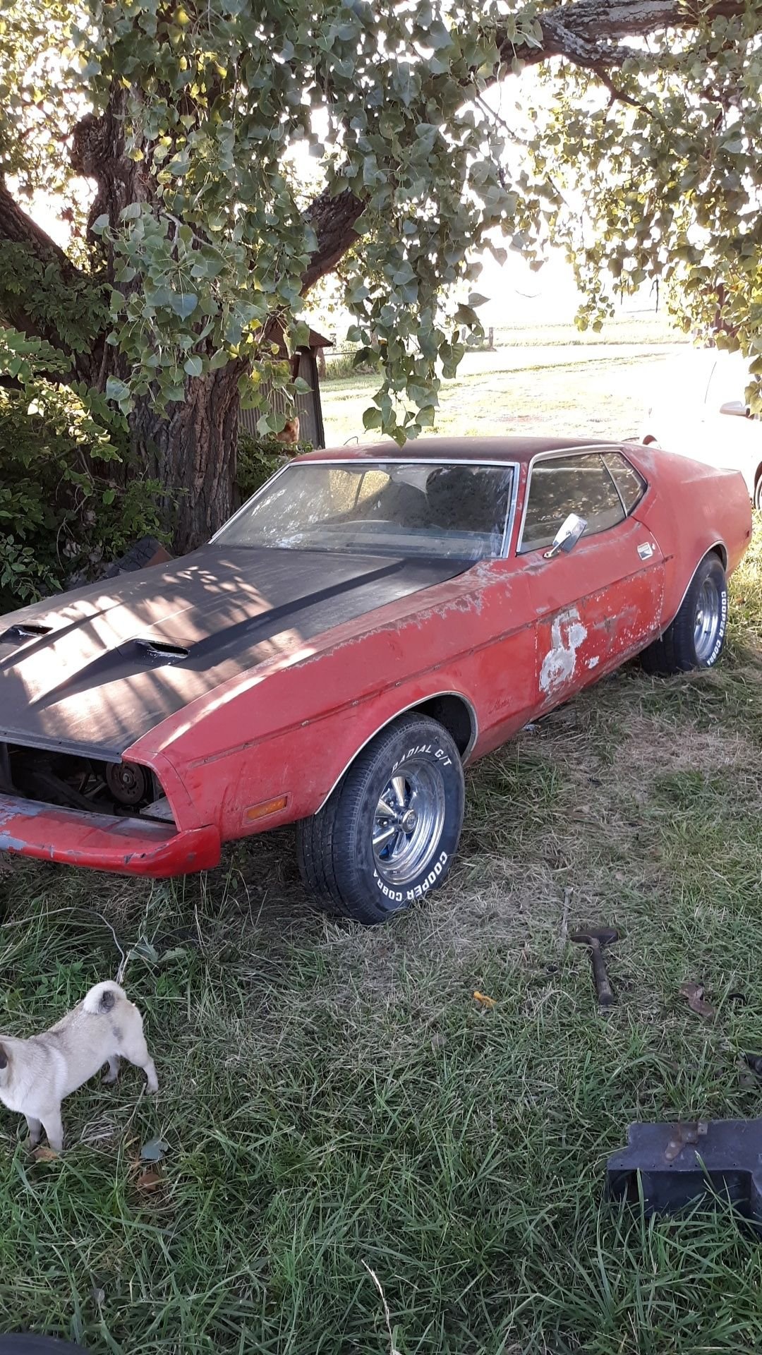

Hello, I've posted on the correct website/forum and didn't get any responses. So I'm gonna try it here. Sorry if I offend anyone since this is a truck forum. But I have a car, with a 3 speed top loader than I'm fixing up. I was in the process of using my ford F1 to drag it up on the trailer, and the motor is locked up in the car and I forget to put it in neutral. So after a good yank I realized it was still in gear. Well it took a good amount of force to get it into neutral and now it wont engage any of the gears and the shifter is stiff and feels messed up. What did I screw up? Thanks. Car is a 73 Mustang. I posted on the mustang website for these specific years and got no responses, so sorry if I offend anyone for posting here.

Hello, I've posted on the correct website/forum and didn't get any responses. So I'm gonna try it here. Sorry if I offend anyone since this is a truck forum. But I have a 1973 Mustang with a 3 speed top loader with floor shift that I'm fixing up. I was in the process of using my ford F1 to drag it up on the trailer, and the motor is locked up in the car and I forget to put it in neutral.
So after a good yank I realized it was still in gear. Well it took a good amount of force to get it into neutral and now it wont engage any of the gears and the shifter is stiff and feels messed up. What did I screw up? Thanks. I posted on the mustang website for these specific years and got no responses.

Do you know that it wasn't hard to get into gear(s) before pulling it? I've never heard of a transmission being damaged that way, which doesn't mean it's not possible. Were the rear tires sunk into the ground or anything?
From the posts above, I think your best course is to test the transmission by using the gear selector levers independently of the shifter. Do you know the rear axle to not be locked up for sure?
I strongly suspect that you didn't ruin that transmission by dragging the car.
If you're going to get all off-topic with a Mustang and all, the least you could do would be to post up some pics!
Sportsroof?

Clutch in or out it doesn't make any difference, the trans engaged all the gears flawlessly before I went cave man on it. It was in 3rd gear up against the trailer ramps when I tried pulling it. My 48 F1 had a 1000 pounds of feed in the back and it has the crash box 4 speed with the granny low so it really put some pulling power on it for a second. I'm gonna crawl under there tonight and shift it by hand and see what happens. Thanks for the respones. It's a 73 fastback that I saved from the scrap yard for scrap price. I seen one of its fenders sticking out of the bed of a guys truck under a bunch of scrap at a gas station. I have a wrecked 72 that I redid a few years ago that was hit pretty hard on the drivers side last year, so I was looking for a fender and talked to the guy and lead me to the complete car in his grandpa's barn. 250 bucks was worth it to me for sure!! I'm using everything from the wrecked 72 to build the 73. I was counting on this trans to work, because I spent all my budget on a 351w!! Lol
