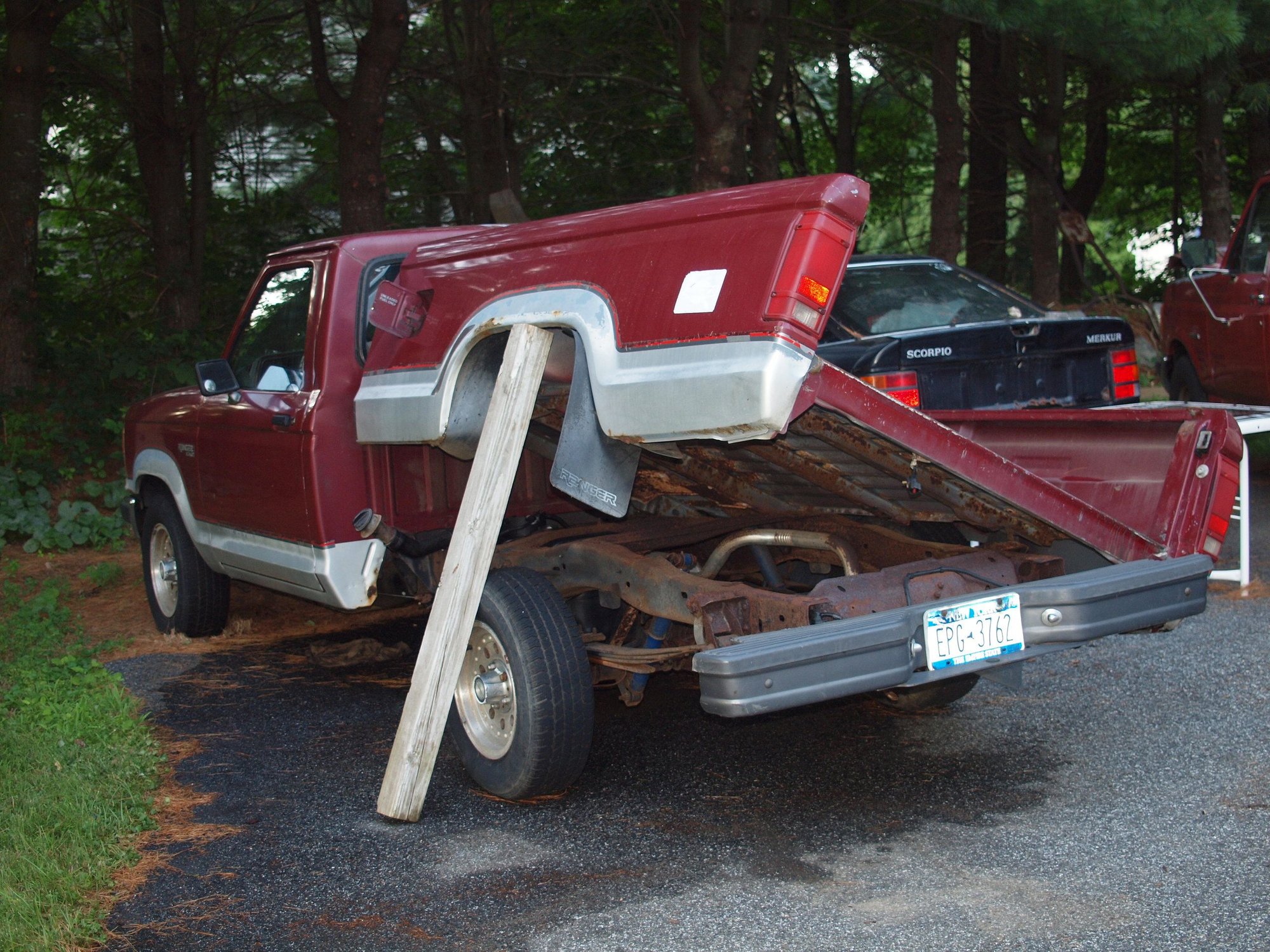

For future searches, I did a bed "removal" by myself using the red-neck method pictured below. It's actually pretty stable like this since the right side bottoms out on the tire and can't really move anywhere to easily.
As others have mentioned, I also found that the fuel filler hose was in need of replacement.
