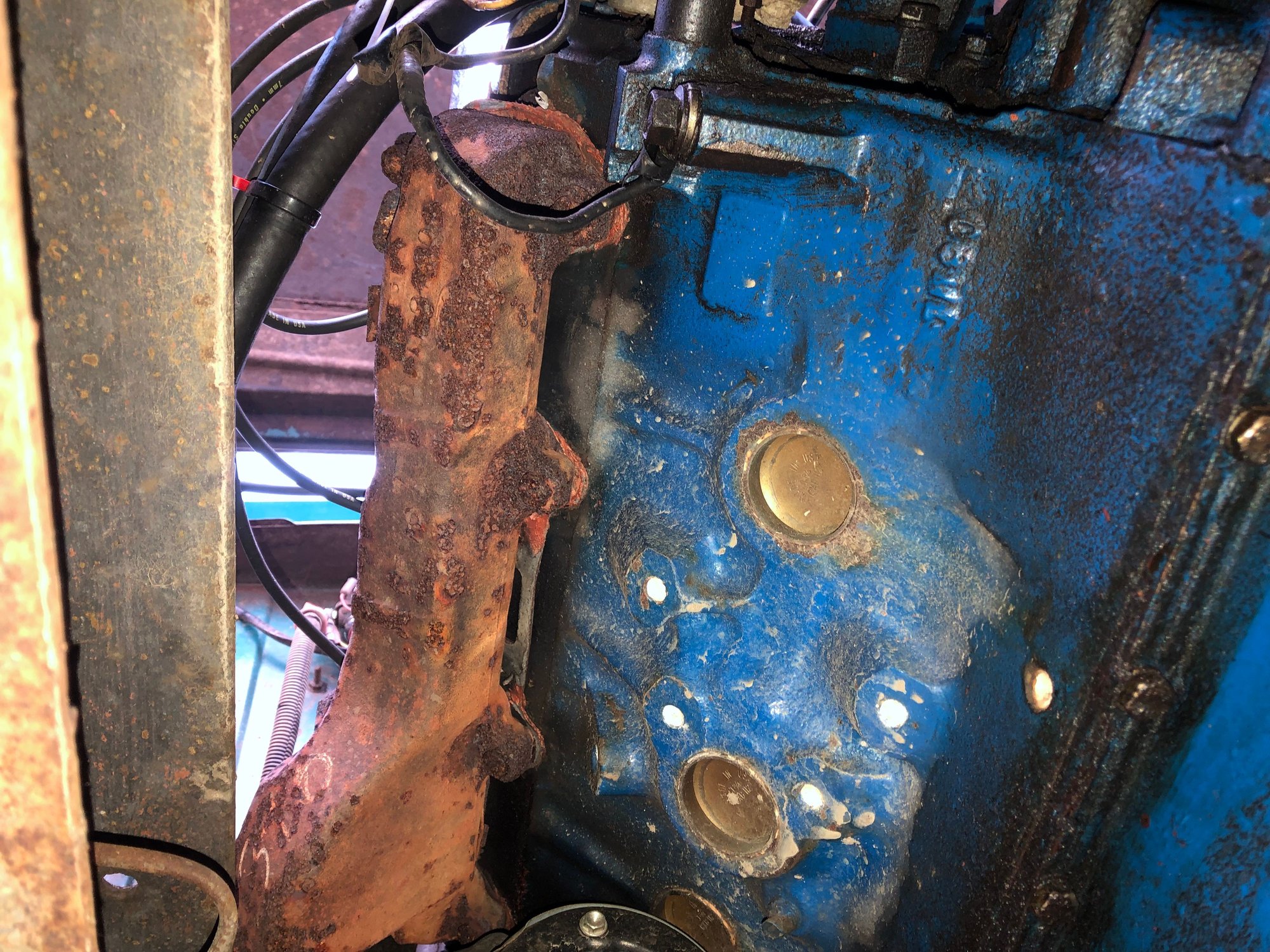

Well looks like I’m keeping my f350 since I haven’t heard from the guy who I was going to trade with. Truck has a 352 with broken exhaust manifold studs. So about to order new heads. My engine is currently painted and I doubt I’ll be able to match it. Any ideas on a color that u all think would look good with the blue?

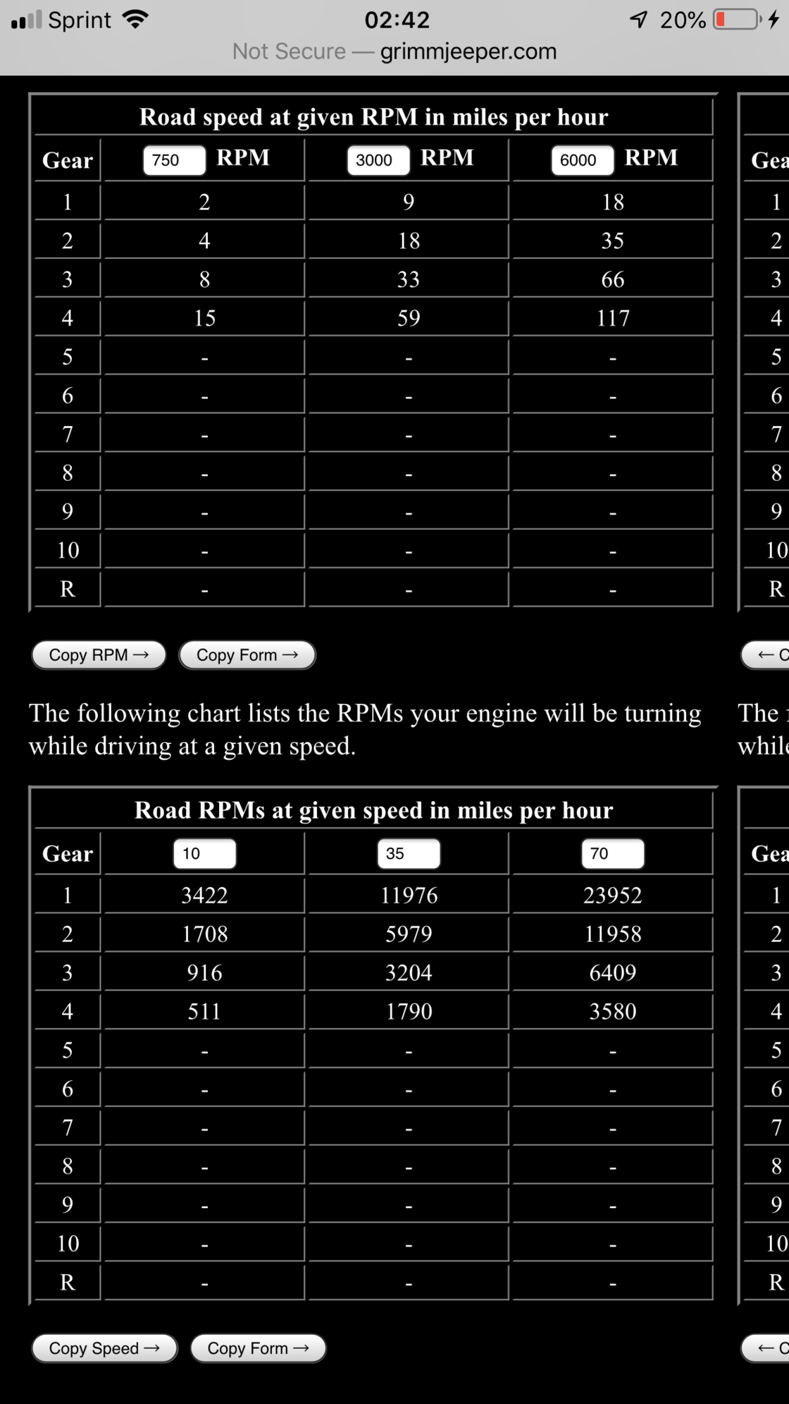

Thank u. I was trying to find out if it is worth doing those mods to my engine with the gearing I have or would it be a waste of money. My gearing is 4.83 with the Np 435. So I’m turning close to 6k rpms doing 60 according to my ratio calculator. So I’m guessing that’s pushing the engine way to hard...

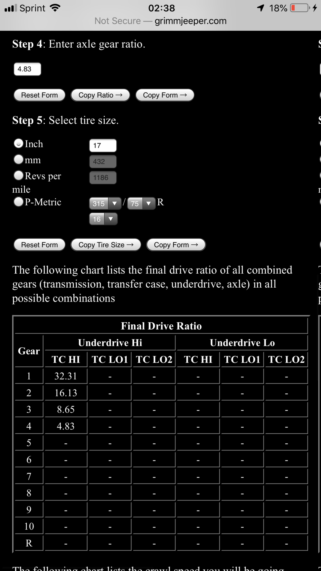

What tire are you running. 6000 doesn't sound right. With 30 inch tires you will turn 3246 rpm at 60 mph. At 6000 rpm you will be going 111 mph.

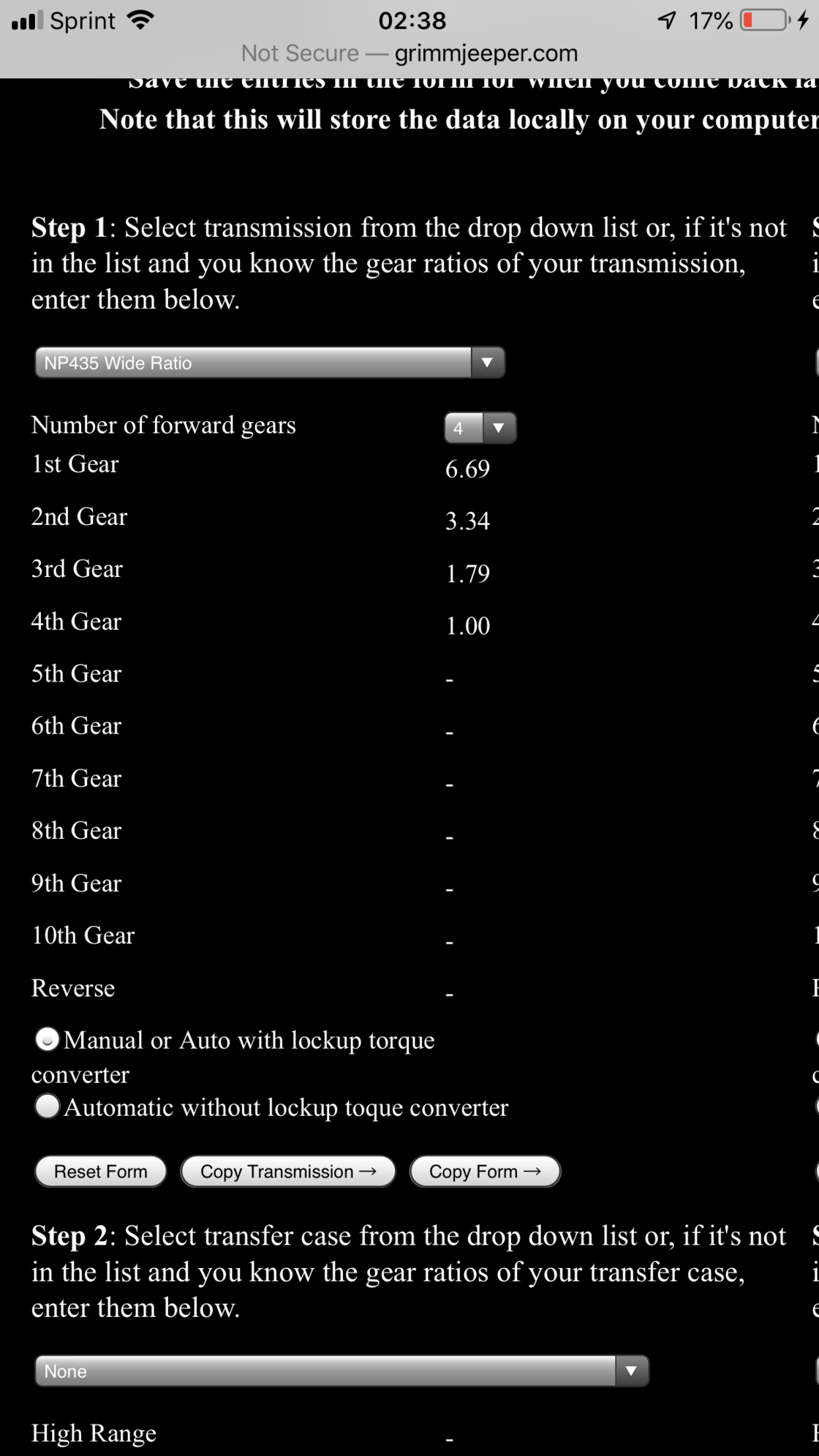

I’m running 17” tires. Here is my info...

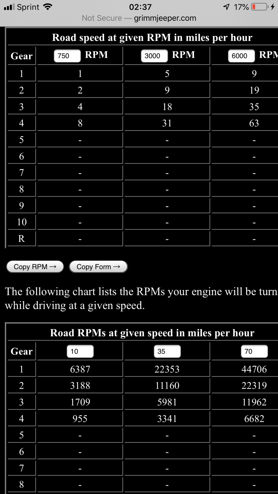

Ok, made a major mistake. I fixed my tire size. Running 235/85/16 and got better numbers...
