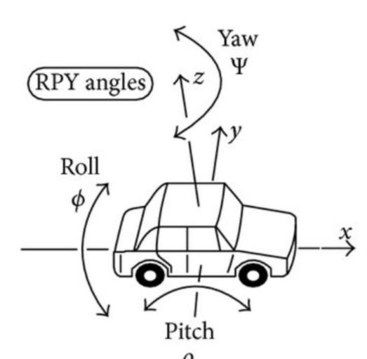

Originally Posted by zeroo
Just an FYI, if you don’t need a sway bar it neuters your trucks trailer sway. Control.
Incorrect. The Ford system measures both the vehicle’s body roll-rate and roll angle, along with the yaw rate before activating one or more of the individual brakes. A sway bar won't affect the yaw.
If that is the case (and I BELIEVE it is) then he is semi correct. The sway bar will reduce the rate/angle and yaw so the system will not be triggered as often as the sway bar does its work first and often. Good case for a bigger sway bar...
The anti-sway bar can only affect the roll angle. It can't affect the yaw.
Concur, I should not have added that (Yaw).
