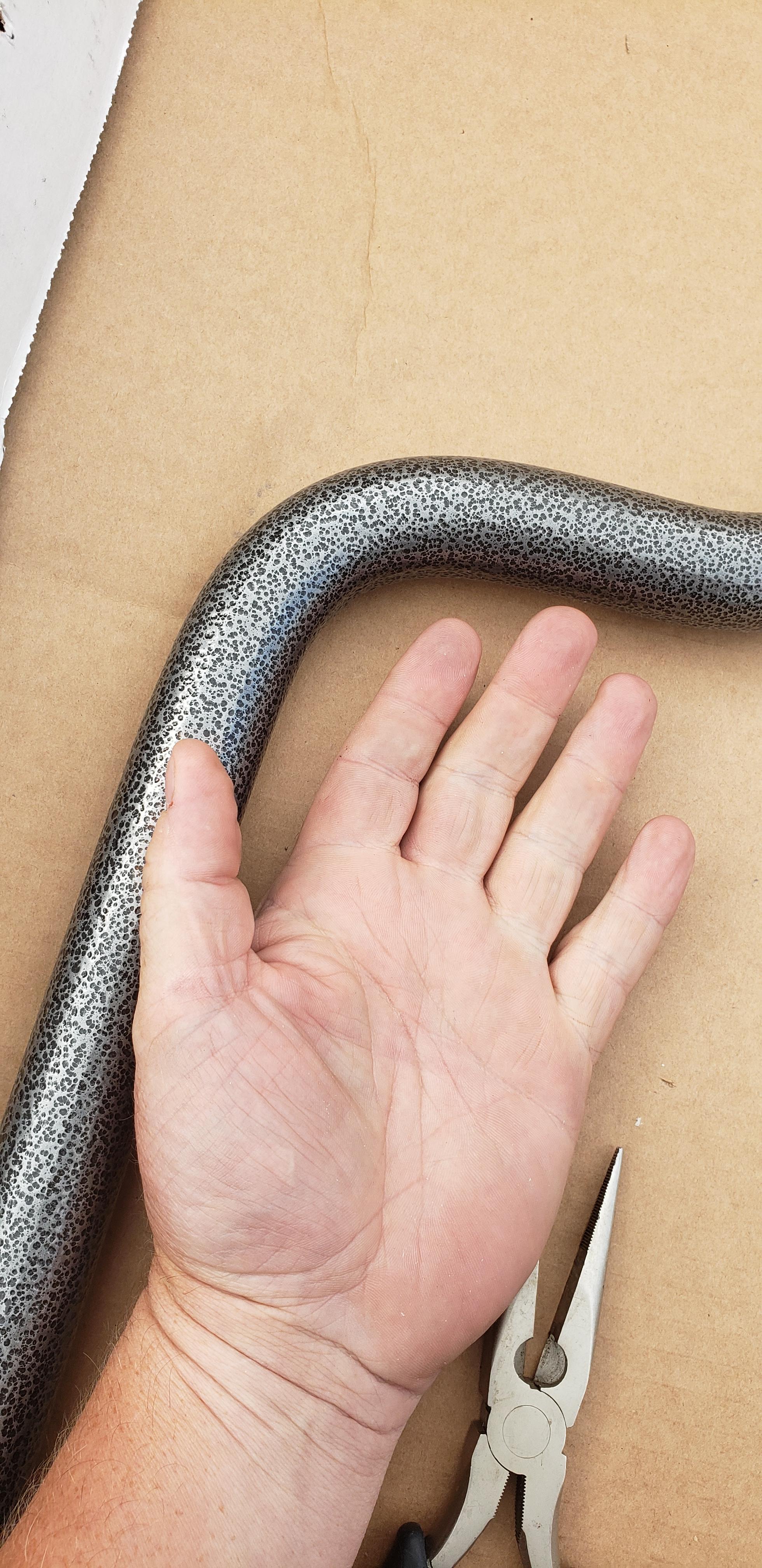

Received and installed my Hellwig Bigwig swaybar. Can't wait to load the camper and see the change!

What did you need to do to do the install on the drivers side, is the fuel/Def tank in your way or what?
I installed the drivers frame bracket and thought how the heck am I going to get the upper link nut and bolt together. I removed the bolt that holds the frame bracket in and it exposed it easily. Tightened it all up and then re-installed the frame bracket bolt. It actually was really quite easy, until I used the wrong bolt and had to take it apart and swap them. lol

Loaded the camper today for the first time since installing the bar. It sure is a LOT less rocky while driving. Very happy with the results so far.
