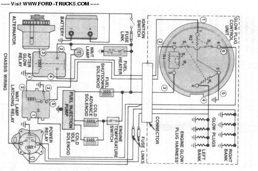

Posts: 277
Originally Posted by lonewolf_
OK there is a Cold start advance solenoid in the Injection Pump too. it works from a Temp switch.
That one is a little more involved.
But they both still work off the same Temp Switch
thank you for the diagrams and the information

lonewolf_
Scope Wizard
Joined: May 2019
Posts: 6,530
Likes: 25
OK that is the engine Temp Switch ... and yes when Engine is Cold that switch is CLOSED and energizes Both Solenoids .... when Engine warms up a BIT then it opens and the Solenoids turn off. that was the Item I wanted you to test for voltage
and it is not hard to change, you won't loose much coolant.
