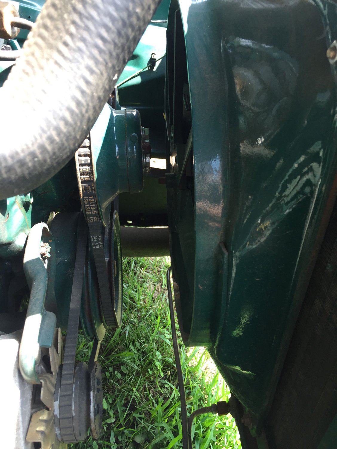

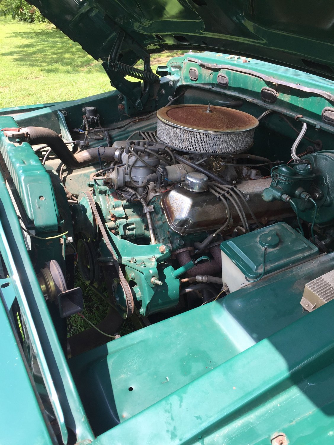

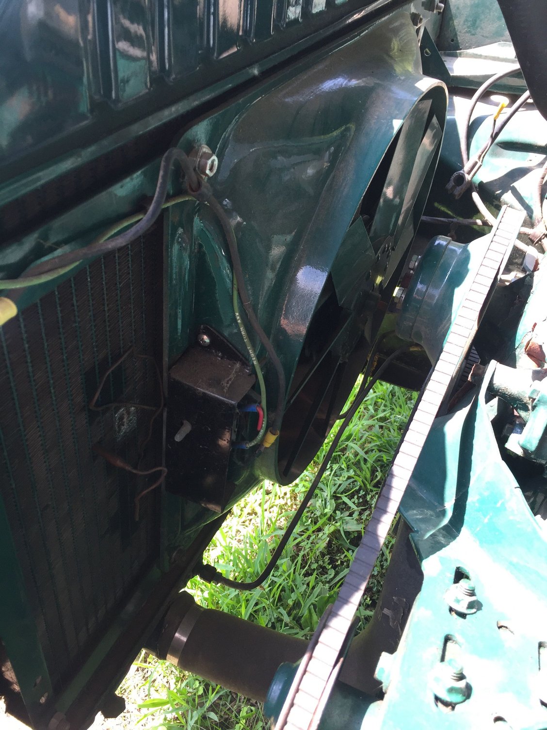

I have the exact set up on my 67 f100. I really like it. Also frees up a little HP

Awesome. I think I am going to junk-yard diving soon and see if I can't get myself a radiator fan. My current fan is actually quite heavy and their is no shroud.... plus removing it would help me add other things to the block like a power steering pump or a better alternator bracket!!
Do you have any pictures of your setup? I would love to see your rig.
