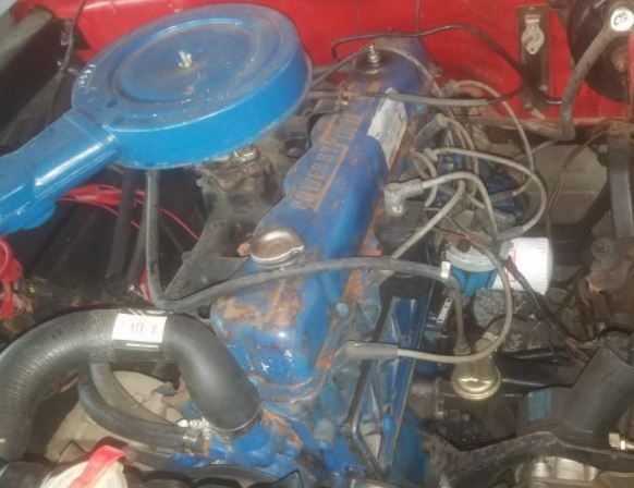

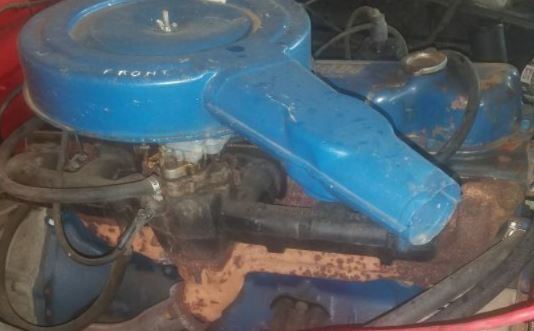

No heat riser on there. Here are the only pics I have at the moment for the fuel line route. The line is a little shorter now and it runs behind the oil filler cap, but takes roughly the same route. Is there a better way to run this? I have some heat shielding for cables/lines that I will try on there if there is no other way.

Modern gasoline is probably more prone to vapor lock in an old school open system. I like to use Marvel's in the gas tank for a few different reasons, and this is one of them, it seems to help. Also make sure the distributor mechanical and vacuum ignition advance is working correctly all up and down the RPM range and at cruise. Retarded timing can raise temperatures. Is it pinging or knocking? Of course check for more simple defects, like a loose, worn or glazed fan belt & pulley.
