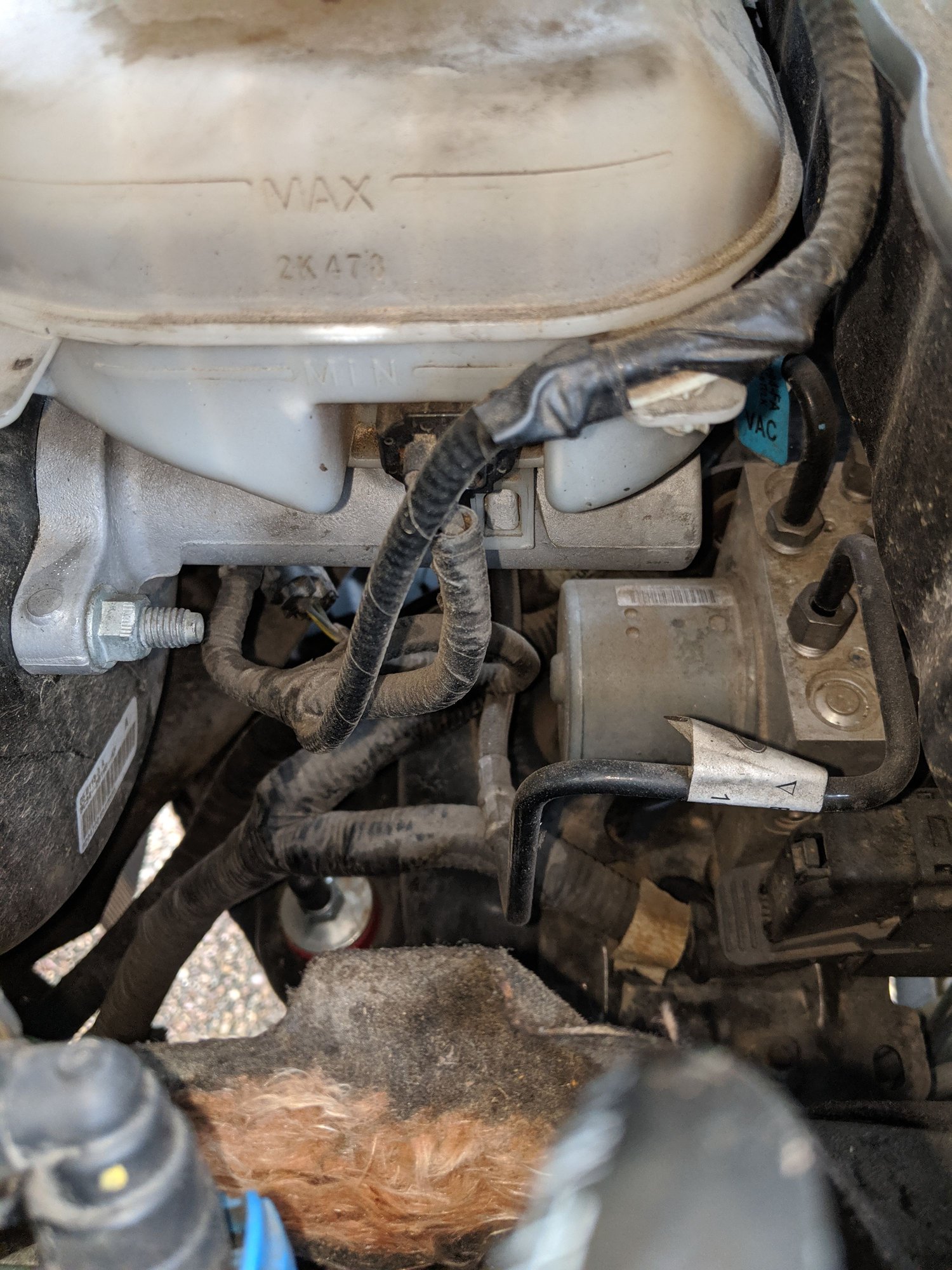

I have a 2015 F350 SuperDuty Lariat DRW with 6.7 diesel. Today I accessed the fuse block, I noticed a disconnected wire terminal and what appeared to be a disconnected vacuum line. The end of the vacuum line is clean indicating it is a recent disconnect. I don't see anything else that it might have been connected to, so I am guessing the wire terminal connected to whatever piece is missing from the end of the vacuum line. The wire & line come up between the fuse block & brake fluid reservoir (?). Looking for some idea of what I'm missing before I head to the Ford Parts or dealer. I don't have 4WD so it isn't for locking hubs as someone suggested elsewhere.

Here are two images I took of this area on my 2011, maybe it'll help.

Kper05, your truck is equipped with vacuum assist brakes. I see the OP's truck is equipped with hydroboost.

The missing part.
Another missing part.
The green triangle highlights the missing part described above.
....and this is the part number from Ford, for the missing part. CC3Z-9C493-C.
