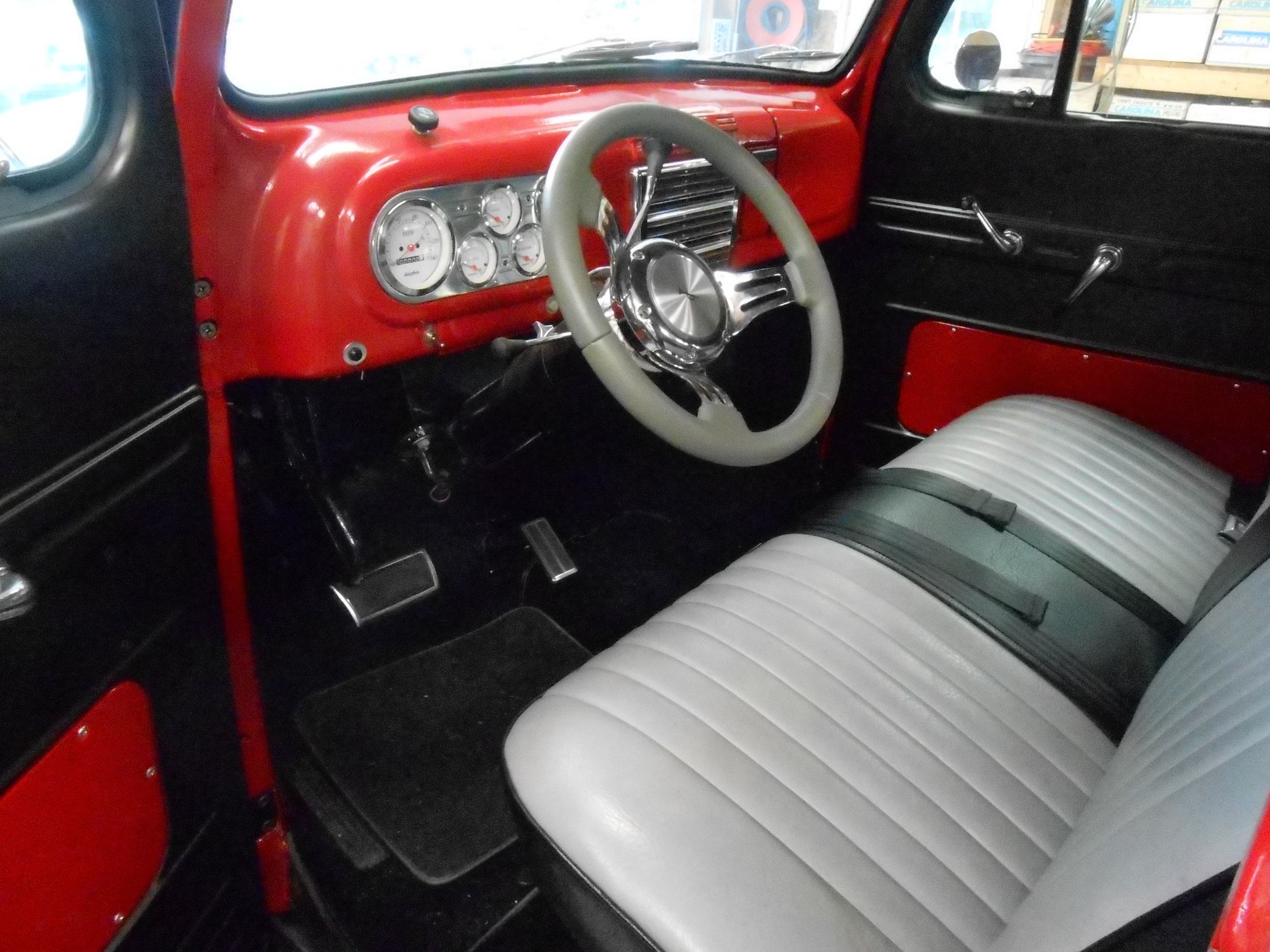

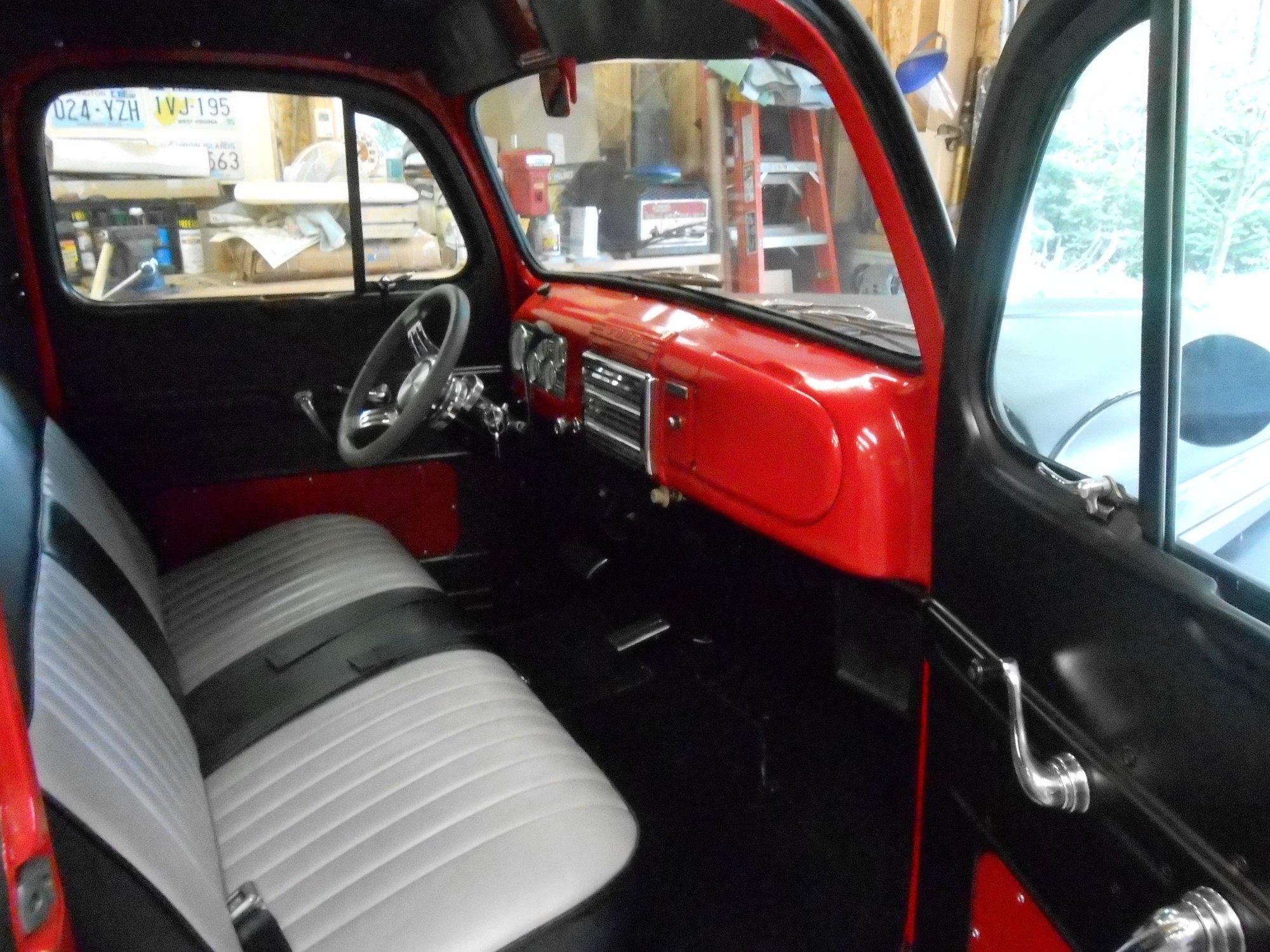

I'm 6'2" and 215 pounds. The seat is more important than the column as far as fitting in the cab. What seat will you be using? The original bench seat has a thick back and a very upright position which I found uncomfortable. I got a bench seat from a 1990 Ford Ranger which has a much thinner back and mounted it on the original seat track. However, I modified the seat track by cutting off about three inches of the rear "legs" in order to lean the seat back more. Then I welded a piece of angle iron to the bottom of the seat tracks. This gives you more room at the wheel and I was still able to use the original tool tray and gas tank behind the seat. I used a stock steering column out of a 1975 Chevelle which worked out very well.
