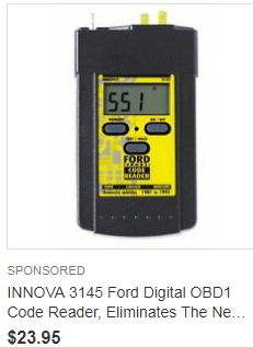

here's a thought, back up and punt, then give all truck info you can, yr, model, motor, trans, you know things that would actually help get your truck symptoms diagnosed, could get a Ford OBD I code reader, if your having that hard of time decoding flashes
many of us have this one, life is so much easier with it
