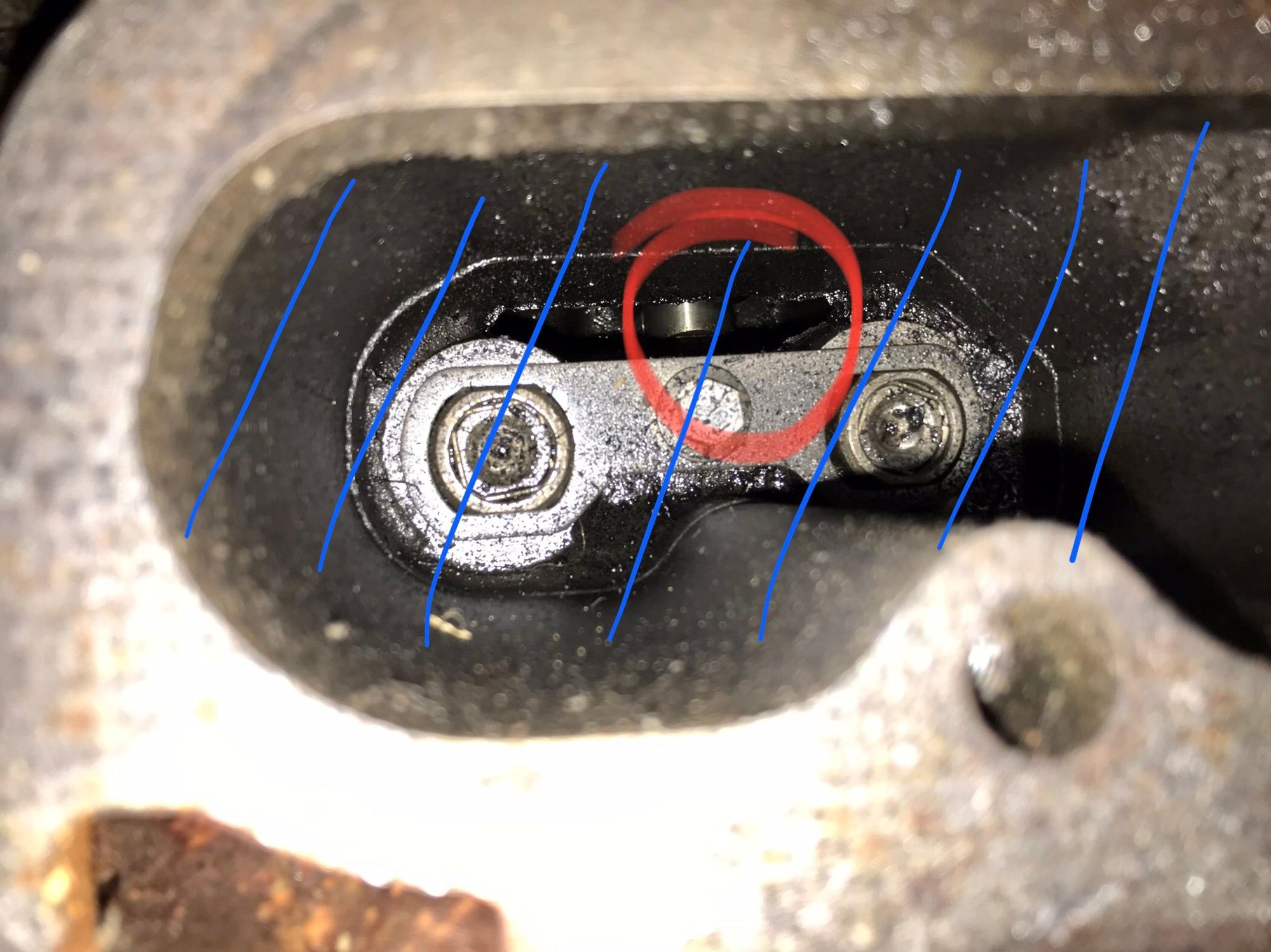

I don’t think it’s good news about the diverter lost down the pushrod hole...
Looks like it’s pretty easily stopped by the head gasket that covers most of the opening for pushrods. Below that are the lifters and cam and the remainder of the rotating assembly with very little clearance between crank counter balance and block. A friends truck recently ate a pushrod and it ended up wedged between crank and block and required crank to be unbolted to be removed.
The red circle is a roller lifter and the blue lines represent where the head gasket would be. (Head removed from block in this pic)
Not a great pic, but lower image shows head on and the head gasket that is visible through the pushrod opening.
