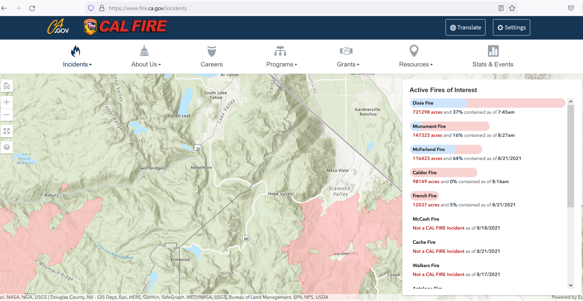

Now here's a related prayer request. Some of my van parts necessary to put it back together with the original brackets and either with or without the second 5kw alternator are at the 90-year old family cabin on US Hwy 50 North East of Twin Bridges. If you have time to say a prayer, please pray for the firefighters' safety and for the preservation of life and cabins along the Hwy 50/S.Fork Am. River corridor:

The wildfires this year have been insane... Along with the dry weather and extreme temperatures... We all hope for the best for the lives of those in/around the effected areas.
