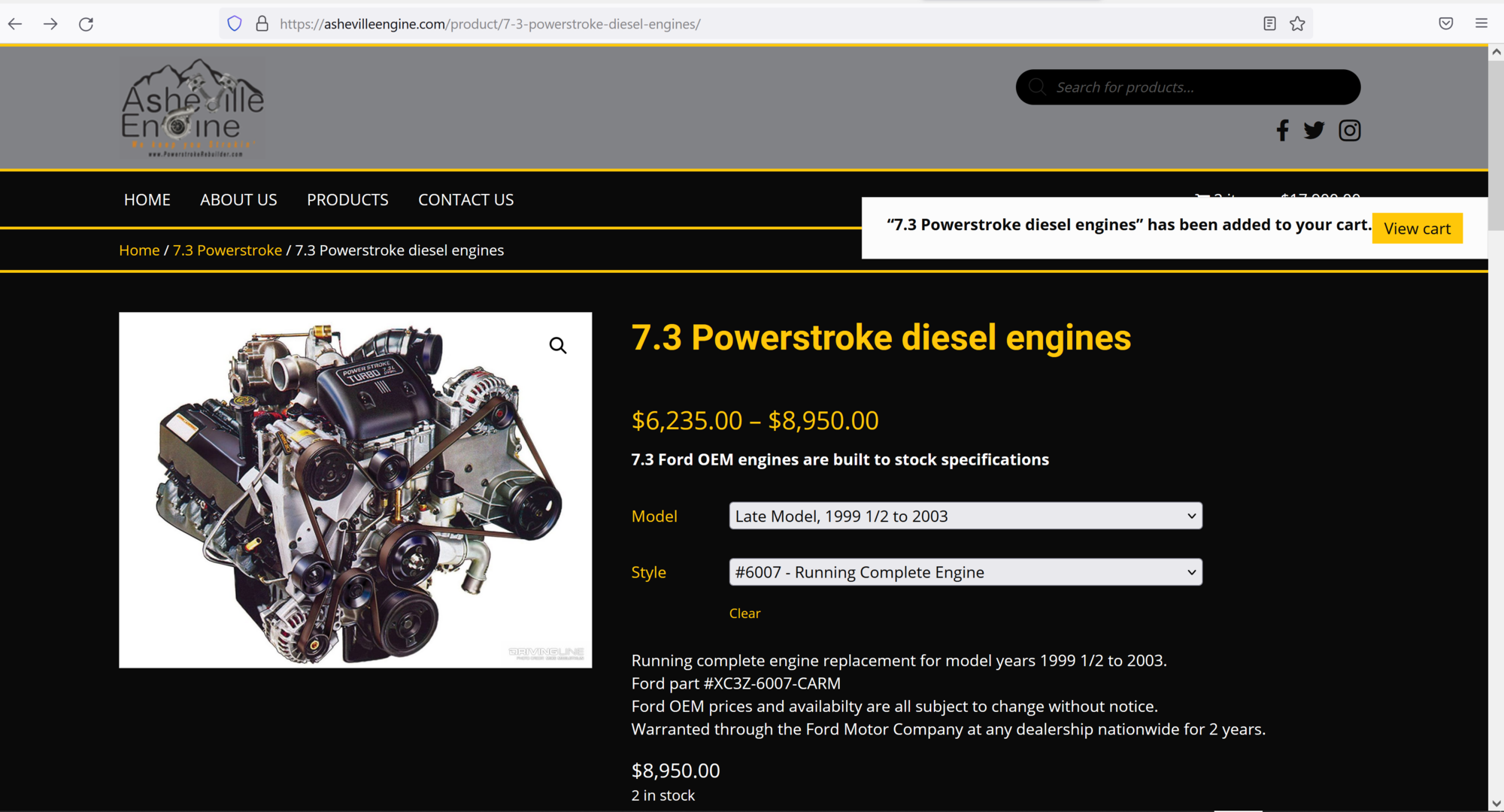

What is my best path forward?
I can do a leak down test on cylinder # 1. I have the OTC leak down tester (bought for another reason). But I really don't know how to use it. But I can follow the instructions.
But what about the fact that adding oil to cylinder # 1 brought the compression from 185 psi up to 500 psi? Does this not rule out valves? Does this not rule out a leaky head gasket?
Dude, cylinder # 1 looked great to me on camera (I ordered the same endoscope so I will be able to post up some photos next week).
There was blow-by out the oil fill tube as I remember, but it was not a freight train engine smoke stack type of blow-by.
Should I take the head off the passenger side and check for a blown head gasket? Could adding oil to cylinder # 1 tighten up a leaky head gasket or valves and bring the compression up to 500 psi?
I don't believe I have fully diagnosed the cause of the white smoke or the low compression. The engine could still be good.
If I have to replace the engine I will. And although other people have recommended Jasper engines for a rebuild, I will go with Asheville Engine. But remember my engine is different somehow, because it is in a van.
https://ashevilleengine.com/product/...iesel-engines/
