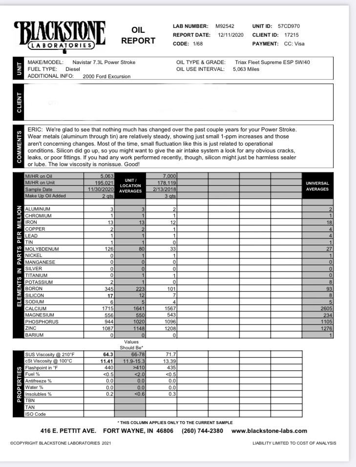

I wanted to get a baseline oil report before switching from Triax Fleet Supreme Synthetic to TSC Traveler Dino.

Here is my UOA report from almost three years ago when I was using T6. I switched over to Triax after this report.

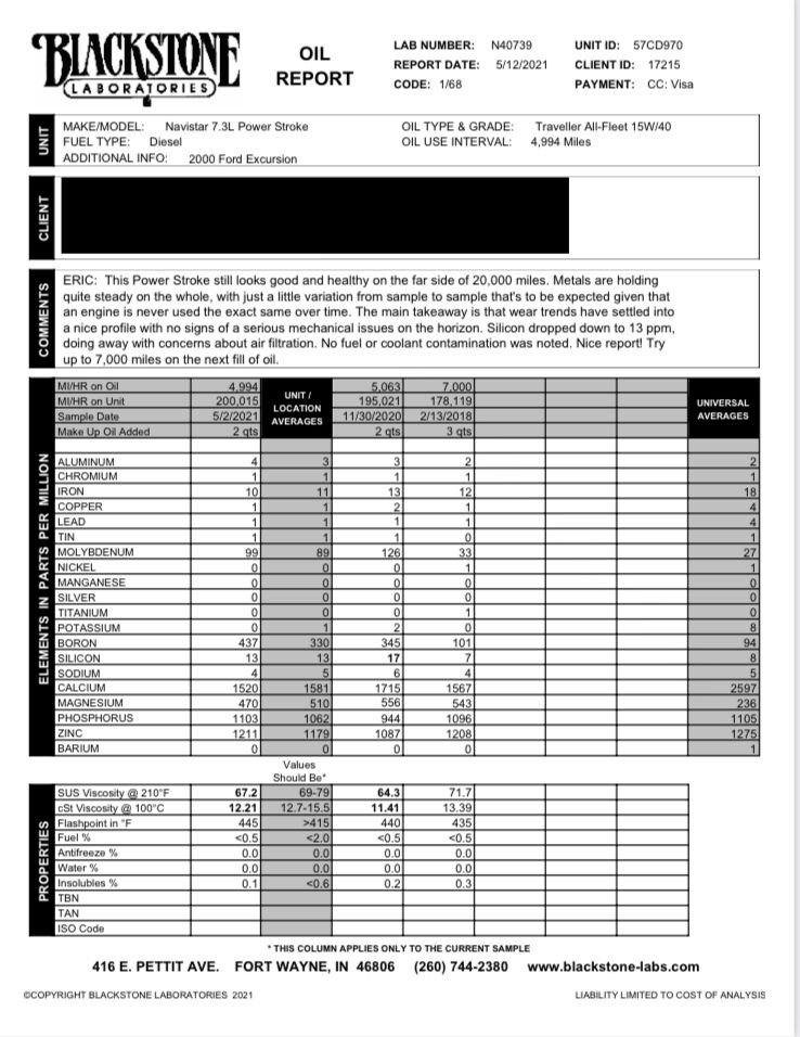

Finished up my nearly 5,000mi OCI. The Traveller looks pretty good to me. Now that we’ve moved into warmer weather I can’t tell the difference between the Triax and this. When cold out I’m not sure if the difference is because I was running the synthetic Triax or because it was 5w-40? Good thing the analysis looks good as I’ve got over 40 gallons left!

Eric, that is great news for those of us considering leaving the "high dollar" oils behind for a readily available oil at 50% the price. Just so we are clear, the 195,021 OCI was Triax Fleet Supreme 5w40 right?
Looks to me the Travelers might have even been better for your Excursion based on the units of measurement.
The MolyB is down a bit, but the Boron is way up, which is a good thing. The aluminum is up by 1, but the iron is down by 3. Again, a good thing in my opinion.
Silicone is down again, did you have an air filter change in there somewhere?
I just read the summary at the top, that is great to hear they suggest you go to 7,000 OCI on Travelers. I fully suspect that if I am not impressed with the Triax Fleet Supreme I just poured in that I will be switching to Travelers, like you did. A couple of friends swear by Travelers anyway and have been running it in their diesels for a long, long time.
Thanks for sharing this with us Eric, you don't have to and we know that. The details in a report of this nature speak volumes to what various oils can and does provide to a healthy engine.
Yep Triax Fleet Supreme 5w-40.
No air filter change, although it might be nearly time. I’ve got almost 3 years on the AIS and over 20k miles. Filter minder is hovering at about 50%.
