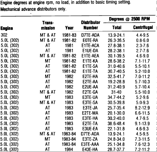

That brings up something, what does the factory book list the dist. advance @ RPM as?
I know your motor is not stock but you have to start some place and knowing what the factory advance should be would help.
I will not get in to how to test all this if what you just changed helped or hurt both timing & carb.
Dave ----
They do say all in by 2500 rpm is the rule of thumb.
On the stock spec this is the closest i can get to spec.
Probably why they say to set the governor on the short slot that is the 20* mechanical slot while the other provides 30*.
So the 10L short slot for 20* max mechanical timing means with 12* initial full advance minus vacuum would be 32*. One could adjust the vacuum advance to limit it to adding just 6* advance which would limit the total advance to 38* total. Think I remember being told sbf engines dont like more than 38* total timing.

There you go as a starting point as you have to start some where.
If you have access to Motor books they may have it broken down with vacuum advance to see if it is different than what you posted.

I will have to check. I got a book with ford engine specs in it and I got a shop manual for my truck but the shop manual I think is Haynes but I can check it for specs.
Really it looks like I should go with the 20* mechanical advance setting then decide where I want it all in which I think 2500 is where everyone states to have all in advance.

Well I need to do some reading. Engine builder I know said I should shoot for 34 to 36 degrees total advance that fords typically dont like a lot of total advance.
Also said to shoot for as much initial advance as possible. I can do 12 degrees initial but would have to limit vacuum advance to 6 degrees or less to keep it under 38 degrees.
