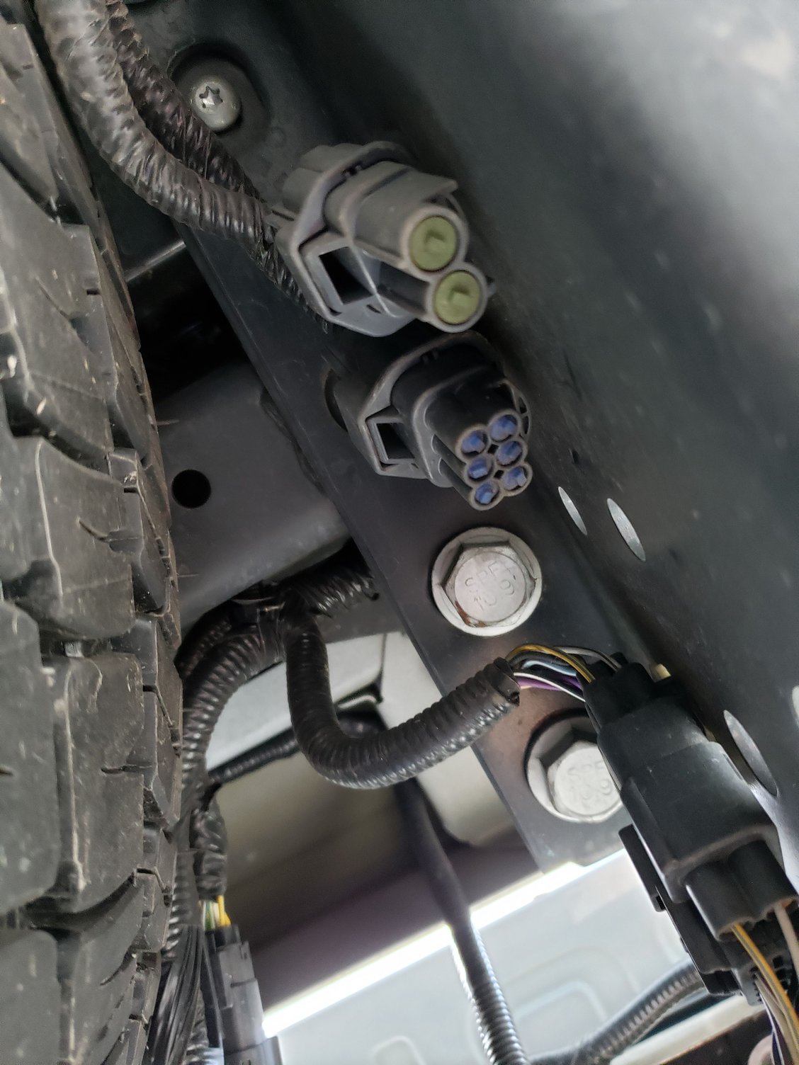

What is this plug for?
They are right next to the rear wheel. There are two - one with two plugs and one with six. 2016 F250 lariat fx4

Has anyone used these for something other than a fifth wheel?

Those are for the 7 pin connector in the bed of the truck for the 5th wheel.
The in bed part number is...
BC3Z-13A576-A

Sure. I used them to connect the oem in bed 7-pin plug and harness for use with my Lance camper. I mounted it forward of the fenderwell which is the beet place for truck campers.
