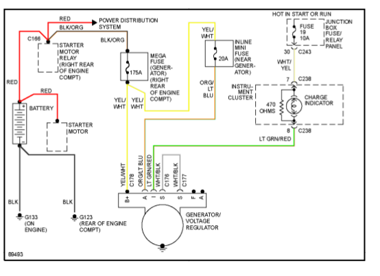

I read somewhere there's a temp sensor for the battery. If the battery's cold the alt. will charge more. If the sensor's bad it will overcharge. I found this...
Old Jul 13, 2019 | 01:53 PM
sunbelt57's Avatar
sunbelt57
Joined: Jul 2011
Posts: 192
Only thing I can think of is 'A' is not getting voltage.

Yes the connector has to be locked down.
I assumed you made sure of this.
In the schematic there is no temperature sensing shown.
Any temperature compensation would be done in the regulator by altering the refencing circuit with a tempesture sensitive variable resistance.
Good luck.
