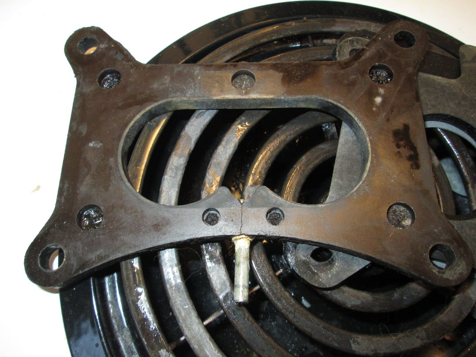

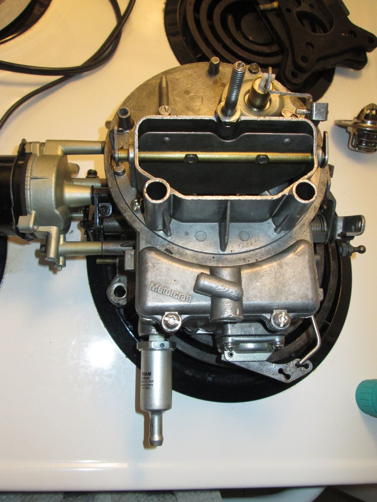

I've been tinkering with my 66 390 and I wanted to verify the carb was the right model for the 390 cause it has some stumble/hesitation at certain part throttle positions.
I noticed the spacer is cracked and only 1 gasket was there.
the spacer is where the trans gets its vacuum.
Can I ditch the spacer and hook the line up elsewhere?
There is a vacuum tree with rubber plugs on it.
Can I use that instead with the newer 1/4" cardboard? spacer?
The carb has V.J. C834A scratched onto it but its more like AUTOLINE C852A for 70-71 Fords.
thanks.

Yes you can feed the trans from the manifold tree. You do need the right carb spacer though. You want to make sure it's a actual 2bbl spacer and not open like the one you have. The air balance is terrible when you dump from both barrels into a open void on a dual plane manifold. It works on a single plane just fine at high rpms.

thanks!
the last image shows the spacer I'll use. I got a new carb base to spacer gasket coming.
