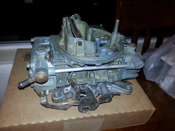

This one looked to be in great condition, and was only $95. They listed it as a "rebuildable core", and it was from a company called BBJ Automotive Cores, which made me feel better about it. Not some carb that had been sitting on the back shelf in someone's garage.

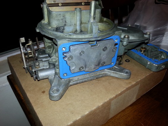

The carb showed up on Friday. It was in excellent condition, and actually looked like it'd been recently rebuilt. It was also very oily (I'm guessing they either sprayed it or dipped it to keep it from drying out.) It had all fresh new gaskets.
Either way, I still pulled it apart to check it over.

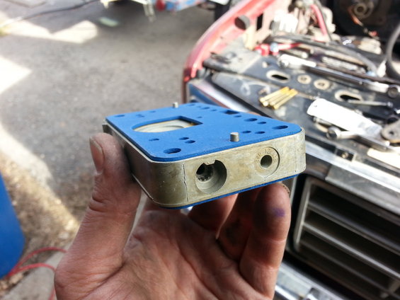

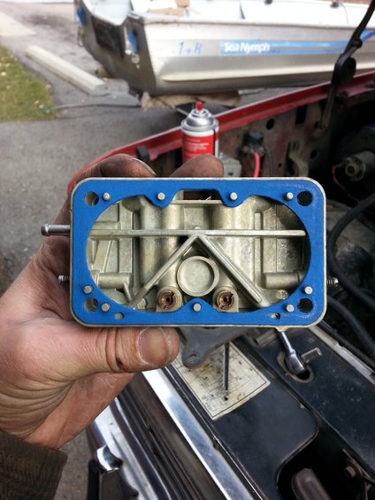

This was my first clue that it had been rebuilt. They only switched to the blue, silicone in recent years to combat the ethanol in fuels, so I knew someone had been through it.
One of the floats had been replaced:

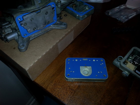

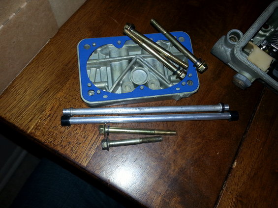

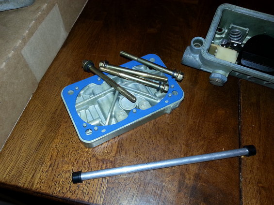

For tuneability, I ordered up a secondary metering block kit. The tech guy at Holley said the original metering plate was equivalent to a size 65 jet, so I put those in to start with.

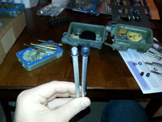

I was also glad because the old style transfer tube uses the o-ring style gasket, which I really don't like. I bought a packet of about 50 and have had these in the garage for my other carburetor. I only have about 5 - 10 left. They generally get pinched and tear every time you remove the transfer tube, or have a habit of popping off and shooting to who knows where.
Another thing I don't like is the paper gaskets for the fuel bowls and needle/seats, since they usually rip apart when removed. Plus, they're difficult to scrape off.

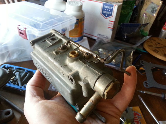

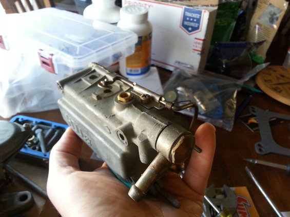

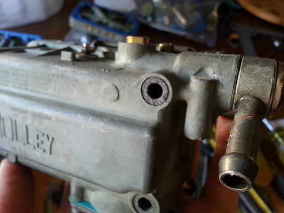

Another oddity I noticed is this little flapper valve. This is the only carburetor I've seen it on. (New ones still include it.) It seems like it opens when you let your foot off the gas and then closes as soon as you start to accelerate. Anyone have any thoughts on why it might be there?

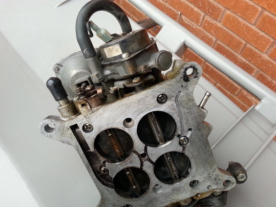

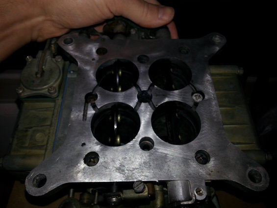

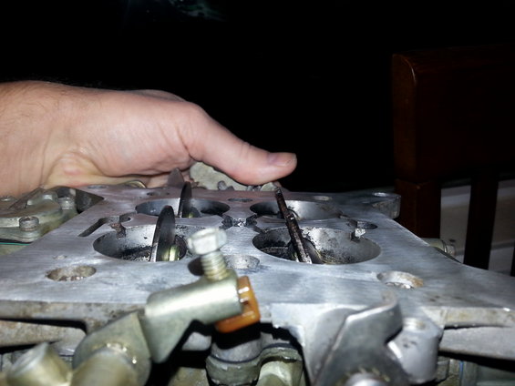

A replacement baseplate for this carburetor is NOT available... anywhere. Holley said they only make them to go on the carb and there isn't even a part number for them because they don't sell them. I just don't get it. It's not like this carb isn't in production anymore. They MAKE the baseplate, but they only make them to afix to the body and sell as a complete unit. No aftermarket company makes one that'll fit it either. It has 1 1/2" bores and everyone makes a 1 11/16" (which is what fits the 600s).
As such, I was extremely grateful that this baseplate was perfectly flat. If it had been warped, I pretty much would have to scrap the whole thing and write it off as a loss. The only way to get a replacement is to just buy another carb new.
The throttle shafts had a little bit of wear, but I took the plate down to a carb guy and he said it wasn't bad enough to need rebushing. He said that since the holes weren't oval and were still round, that those nylon inserts that come in the rebuild kits would be plenty. They were a pain to install, but they seemed to tighten it up really well.
Onward.
I find it interesting that the baseplate also doesn't have ANY vacuum ports on it.

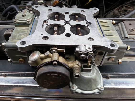

For comparison, here's the underside of my 600cfm carb:
To be sure that I had a perfectly flat surface to bolt the carb to, I purchased a new spacer from Summit. I decided to try the phenolic to see if it helps with heat. For $16 it was a really good deal. The studs were really nice, and I switched mine out for them. The pointed tip on them really makes installing the nuts much easier.

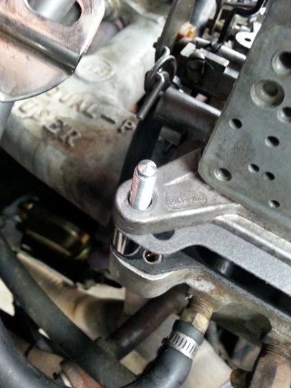

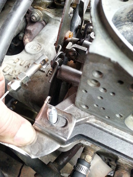

With the carb now on the engine, I went to install the accelerator cable bracket that I bought from Lokar. I immediately discovered that the bracket calls for a square corner on the carb, which this one doesn't have:
Here's the typical corner that most Holleys have:
The 465 has round corners:
Fortunately it didn't seem to be a problem, since after I tightened it all down, it was still very solid and didn't move.

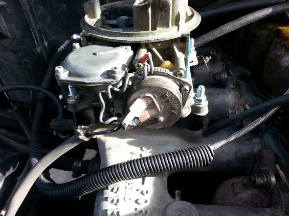

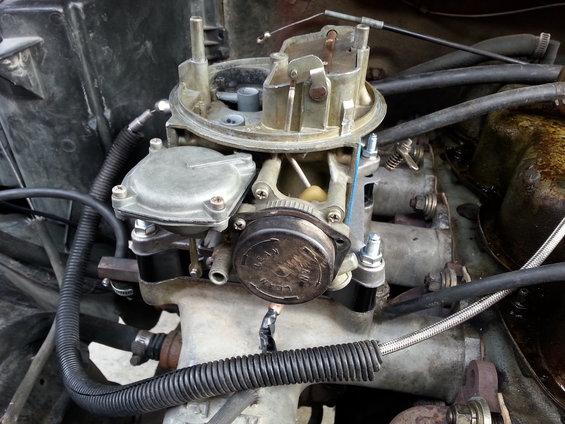

The next upgrade I did was to switch out the choke. The 1848 normally uses a heated choke, which I didn't have any provisions for, so I swapped the cover to the electric one from my other carb.
(I also found later that the port next to the cover pulls in vacuum, so it needs a cap when not in use.)
The secondary metering block didn't come with anything for the vacuum port and idle mixture screws, so I installed some that I had in the garage.

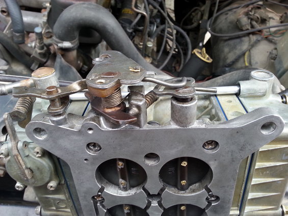

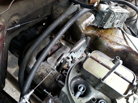

My next big obstacle was hooking up the return spring. To my dismay, the arm on the throttle is absolutely bare bones.
I don't have my own pictures, so here's some stock ones:
vs the typical setup:
There was just simply no where to connect anything. I was about to hang my head dejectedly and pull the whole thing apart to swap the throttle shafts between the carburetors when I remembered the homemade bracket I originally built when I first installed a 4bbl. It let me hook the springs around the throttle cable connection, which worked perfectly (big sigh of relief):

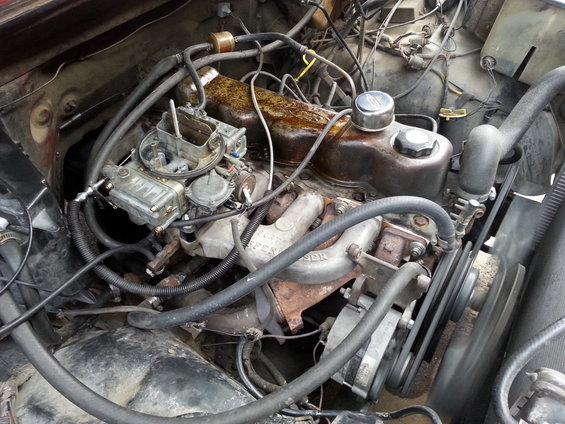

And here it is running!
This is getting pretty long, so I'll post more details on how it ran in another post.

Regarding the idle-activated valve on the top: Is that a vacuum valve? Idle bypass air (a controlled vacuum leak), to assist with hot idle quality?
That poor carburetor, AB. You were waiting so long for it I'll bet you jumped all over it when it arrived.

No idea on the little flapper. It just opens a hole in the top of the fuel bowl. I may write Holley and ask them.
