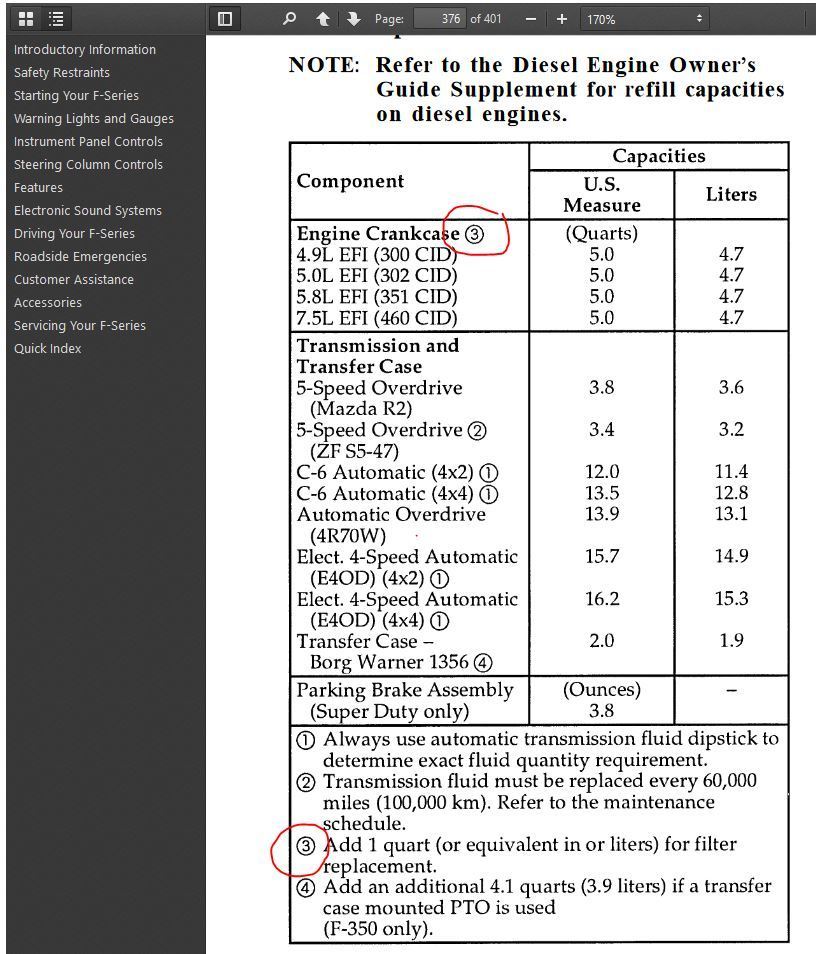

i did the same thing on my 96 460 ... except I over filled it by one qt, Manual says 5, i put in 6. thoughts ?
Old Jul 22, 2019 | 05:53 AM
ATC Crazy's Avatar
ATC Crazy
Top Answer: 10
Joined: Jun 2003
Posts: 12,341
Likes: 4,368
From: SW VA
I'd run it if it were me. What does it show on the dipstick? If my memory is correct, I think it was 5 quarts for an oil change w/o a new filter, and 6 quarts with a new filter.
After looking...I am correct: There is a footnote (3) next to the capacities in the owners manual. That footnote states "Add 1 quart for filter replacement" This brings the total to 6 quarts with a filter change.
