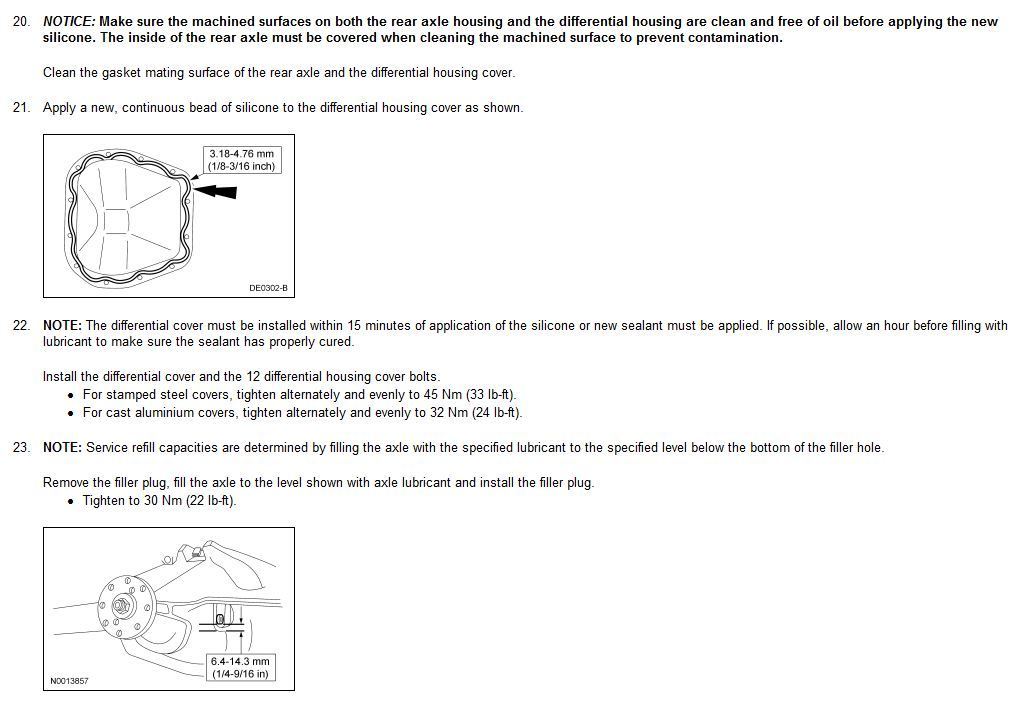

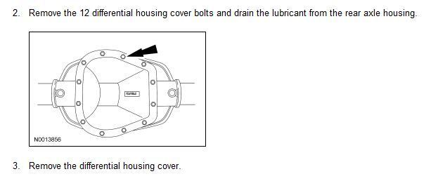

You will find the rear axle service procedure more or less discussed in sections like rear axle differential replacement. This is from the 2014 10.50" Sterling rear axle section.
It will describe removing the cover...
Rear axle cover install and fill...

I own quite a few factory service manuals from different manufacturers (Honda, Subaru, Ford & more) and not a single one has a separate section for standard maintenance tasks. For example, engine oil filter replacement is deep in the engine section, with the oiling system info. As the other poster stated, rear diff fluid is always in the drivetrain section. My oldest manual is for 1999 Honda Accord, they are all basically the same.

Thanks for confirming that. I've grown accustomed to using the Chilton service manual for my truck. After purchasing the workshop manual, I've been familiarizing myself with navigating it and how it is organized. So from what I can conclude, basic service procedures aren't necessarily outlined in a separate section, but are usually discussed in larger service procedures e.g., servicing the differential fluid is covered in the driveline subsection covering rear axle removal and replacement?
