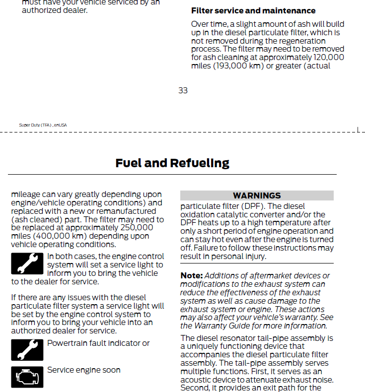

It might make it to 250,000 but it will most likely have issue before that time. The diesel supplement manual states it might need a cleaning at 120,000. Most have DPF issues between 100,000 and 150,000 and then delete it, which is cheaper than replacing it.
From the 2016 diesel supplement:
