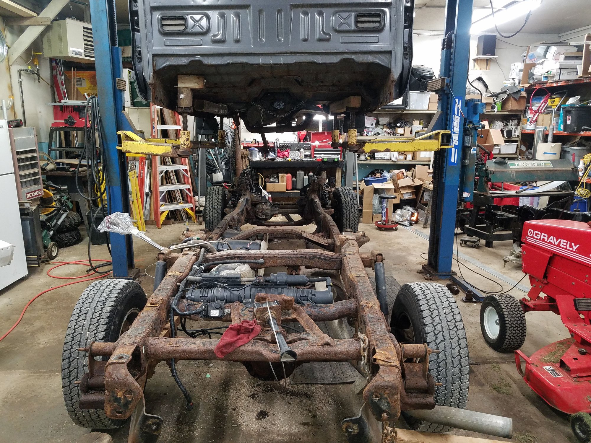

Hi all,
I was literally going to post an update today, glad you asked! Summer was super busy at work and weekday work spilled into the weekends quite often so time or energy to work on the project was quite limited. I have managed to randomly pick away at it from time to time and made some significant progress last night. So far we have prepared the new frame by cleaning it and painting on a coat of POR-15 with a topcoat of frame and chassis paint from a rattle can. I also used Eastwoods internal frame coating for extra protection. We have around 4 hours time and $200 in paint/grinder/sander/supplies for this portion.
As for disassembly of the truck, I've slowly picked away at it until last night where I finally feel like we made some good progress. It wasn't terrible getting it this far although the rust seriously deteriorated most of the clips that hold nuts from turning. First step was removal of the bed/box and that went fairly well. Next I disconnected the driveshafts, hoses, wire harnesses, ground cables etc. Upon planning and studying this truck I've decided to lift the cab and drivetrain (engine, transmission and transfer case) together as an assembly. Much like it was assembled at the factory. I installed a large steel tube over the engine bay and connected a chain to the engine front, installed another chain under the transfer case to some extrusions under the cab. This saved a lot of time as I severely minimized the number of items to disconnect. All coolant, A/C, oil cooler, transmission lines etc were able to stay intact. Even the exhaust y pipe is still bolted to the manifolds as there was a splice in the pipe just before the muffler to utilize. I haven't been religious about writing down every minute spent working on it but I know I don't have more than 8 hours or so for this portion......and a can or two of PB Blaster lol.
Veiw of cab/drivetrain assembly lifted from frame
Engine front suspension
Replacement frame painted and ready
Cleaned and flushed out interior of frame
Donor frame as received
Next is to start transferring chassis parts from the old to the new, hopefully I can pickup the pace to her back on the road! I hope the pictures help tell the story too.

Never thought of moving the engine/ trans with the body........ looks like a good idea.

Ingenious idea to keep the engine with the cab but I have to ask, how stable is it on the lift with all that weight in the front? I would strap the rear of the cab to the lift for piece of mind. It would be bad if it fell off. The engine assembly is on the frame when being built and the cab is lowered down. There's actually not much to disconnect when lifting the cab with the engine on the frame but I like the way you did it.
