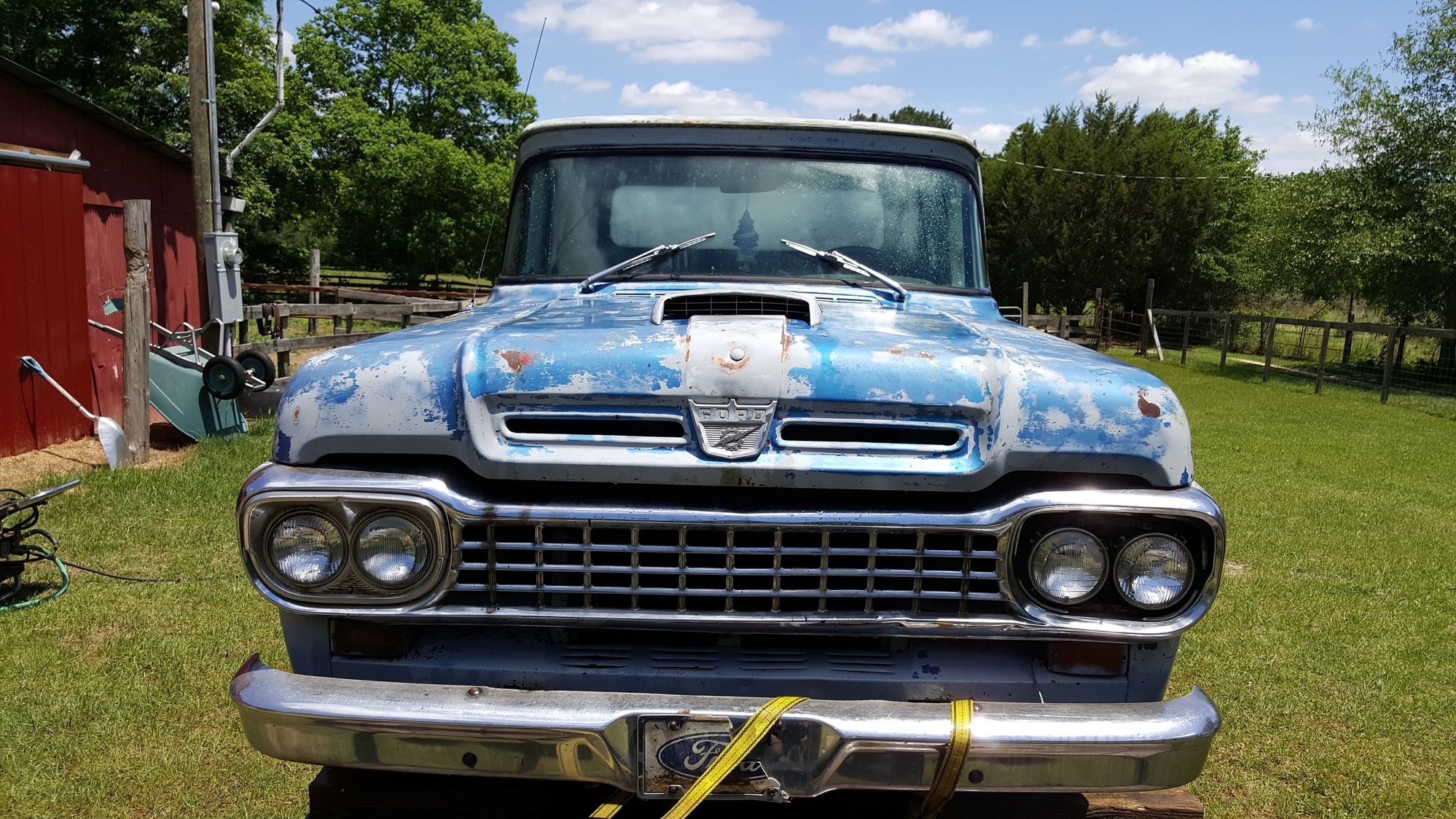

I am new to this site, and I'm sure this has been covered somewhere, but I'm not sure how to find it. I have a 1959 f100 and the frame is warped from the previous owner's stupidity. There is a guy locally that has a ton of older ford trucks sitting around, like a f100 graveyard. What years would have the same frame, or close enough for me to swap my body to another frame. I was going to crown vic subframe swap it, until I noticed the frame warping. Im not sure if I could just swap the entire crown vic frame under it since the wheelbase of my truck is only 110 inches and the crown vic wheelbase is 114 inches. I am open for suggestions on if or what I should do to get this project back moving forward. Thanks in advance for any help.
Ok.. I think I might have gotten off track in my rambling. To make my question a little more clear. I have a 1959 2wd 6.5ft stepside. I need a new frame. What frame should I be looking for that would be easiest to swap my body on? If I have to buy a frame and the CV swap the front end, that's fine. Or can you fit my body on a CV frame without having to do much frame cutting.. I think that's a little better lol

The frame is warped where the motor mounts were welded in. It looks like it warped the top of the rail inward. Almost like it was very hot when they set the motor in it. I wouldnt think just welding would have heated the frame enough to warp it, but you should see the job they did welding and fabricating their "motor mounts" in.

57-60 all use the same frame. There may be some nuances over the run, but the cab, box, steering, and suspension all mount to the same points.
I would start by cutting that mess out and grinding the welds away. A competent fabricator could fix that, usinbg new steel to replace what is unrepairable. A frame swap is easier if you aren’t a welder, but both are fairly involved.

You can’t really tell for sure from the picture, but after cutting off the welded on mess, trimming the rails and welding in some flat 16 gage steel to the upper flange will take, at worst case, a couple of hours per side, not including the trip to the steel shop for material.

The 57/58 frames are the same. The front frame horns are flat. The 59/60 frame horns have a rise as seen in your picture
