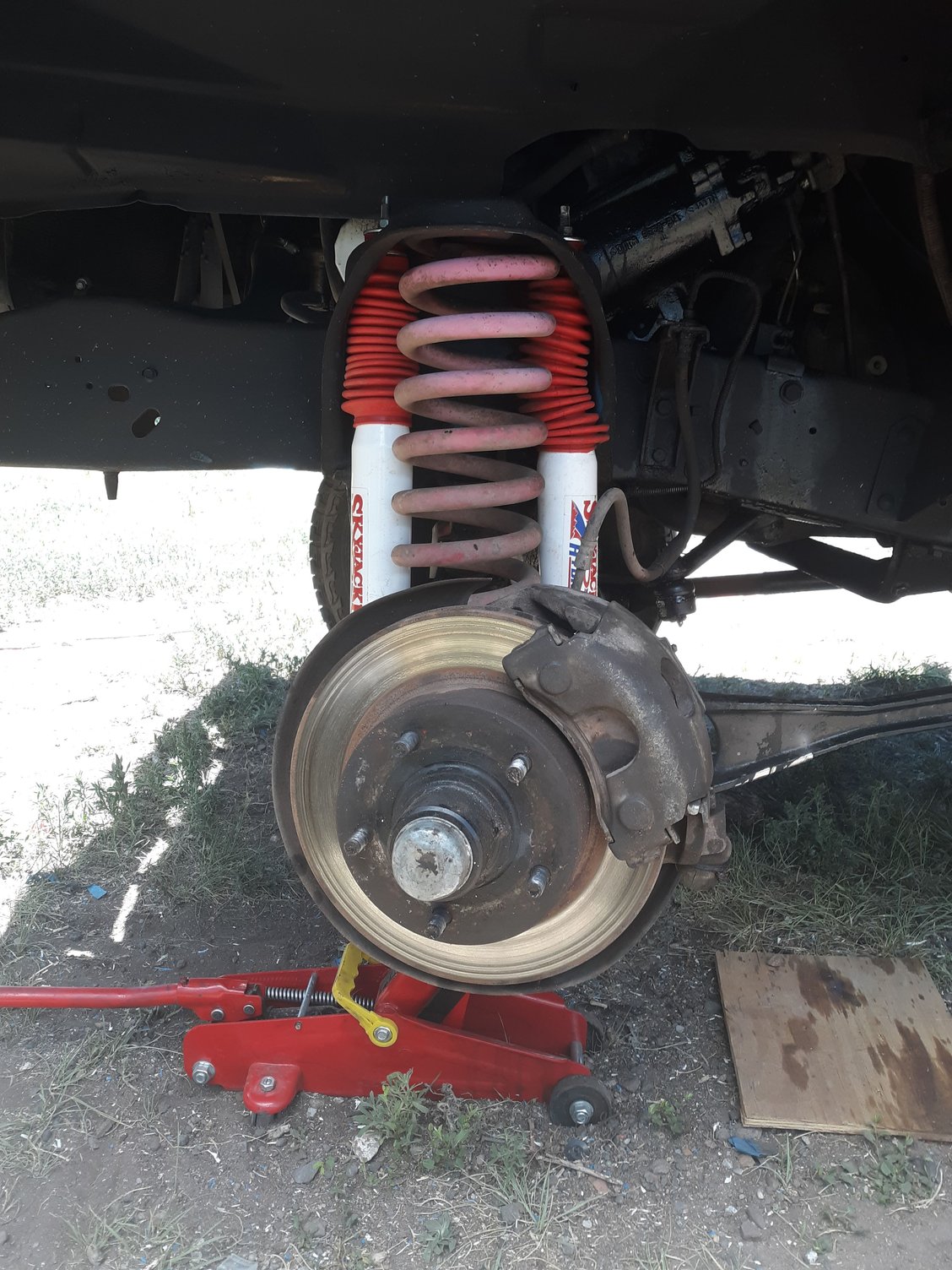

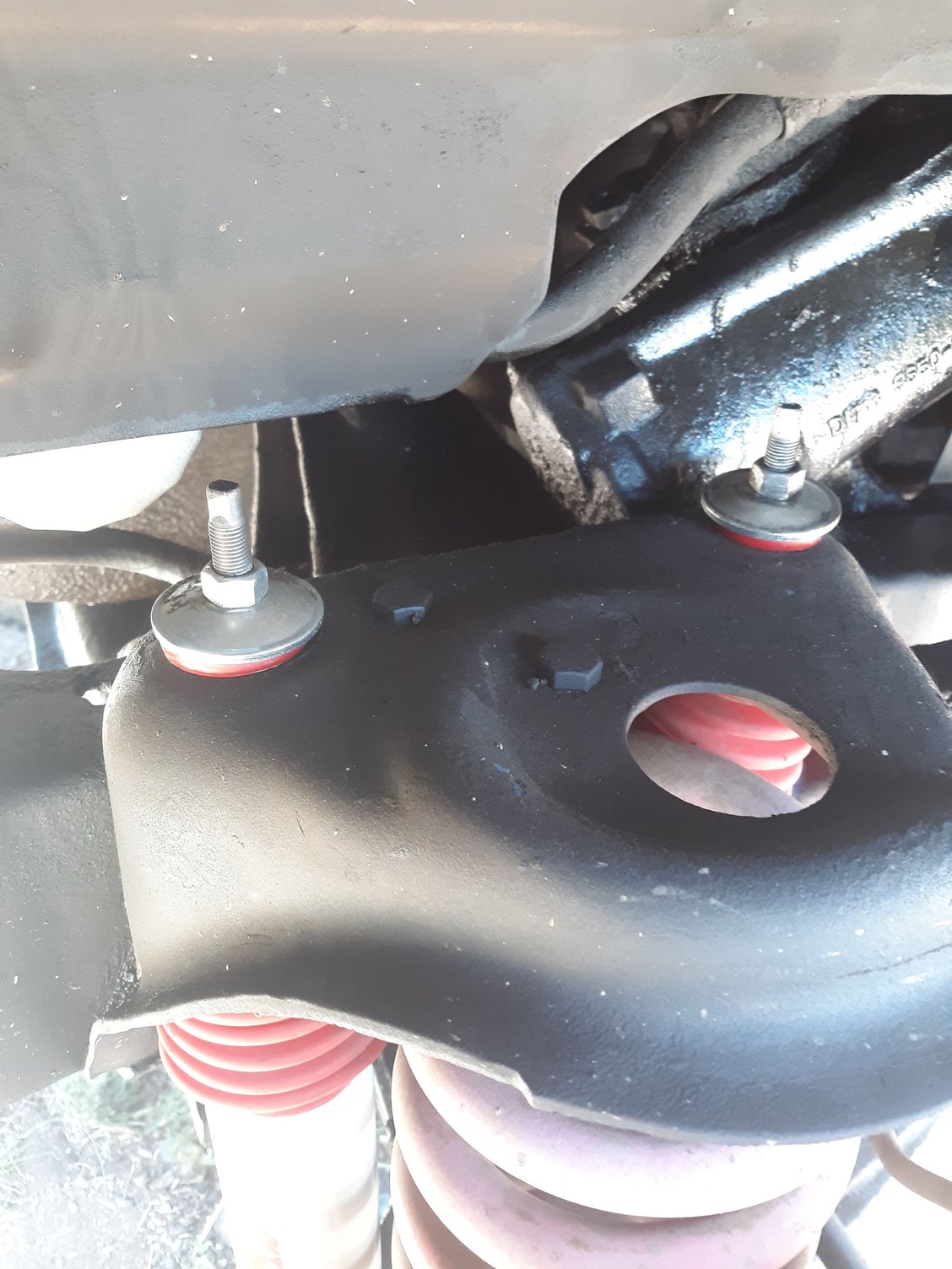

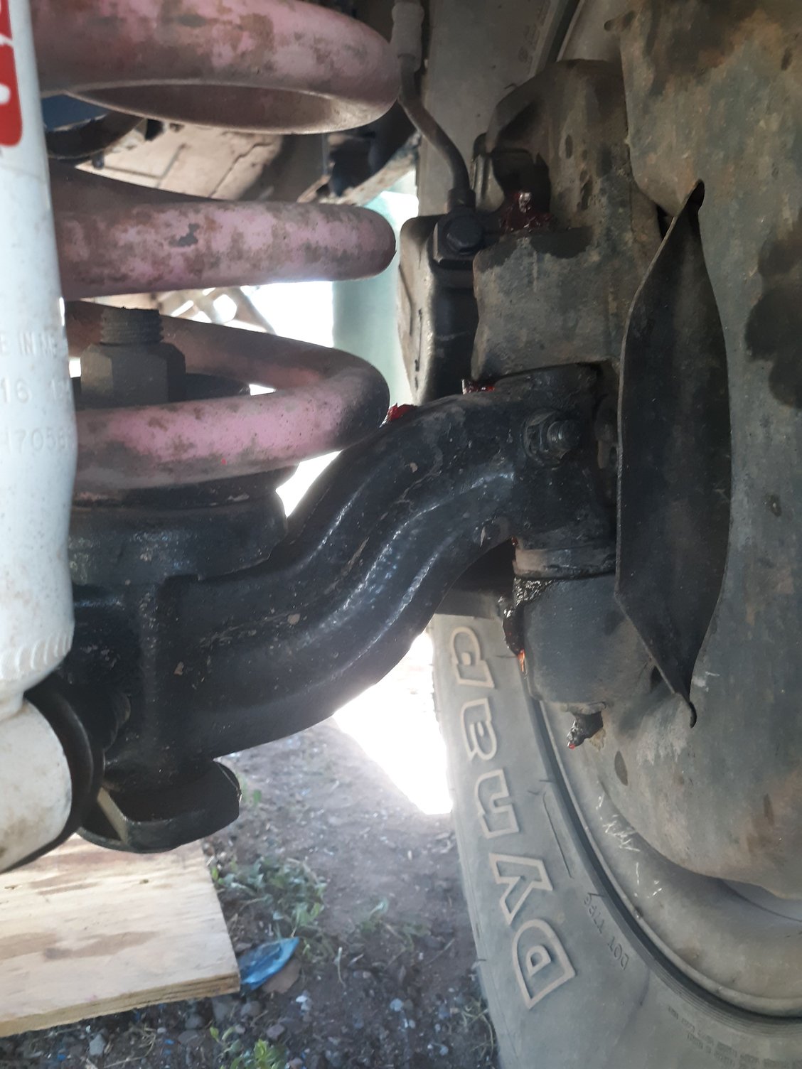

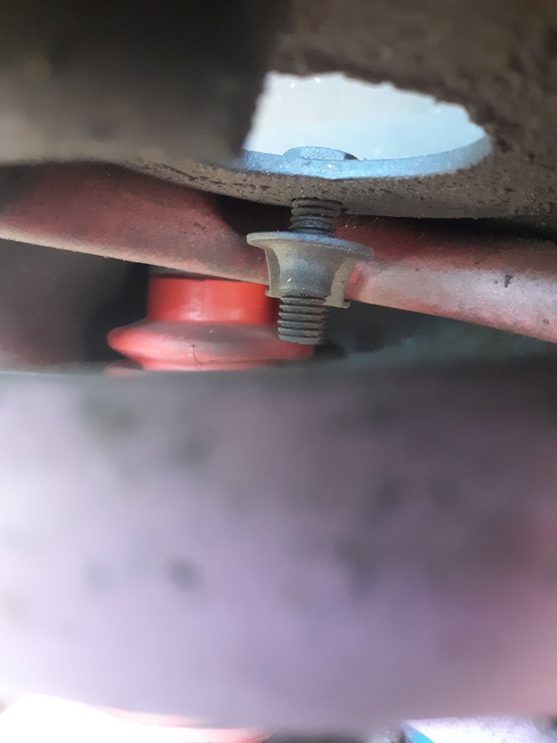

I can do that. I really appreciate the help. Bought truck last year already lifted. I am ASSUMING 4 inch suspension lift, and I know a 3 inch body, because I relocated the front horns 3 inches up and bumper fit perfect. Rear is not lifted as much I believe due to stance, and leaf blocks do not measure 4 inches. More like 3 at most. Guy I bought it from had a prerunner in mind, so I think he did that stance on purpose. Also think rear leafs are sagging, and old. I had a 1/2 cord of wood in there and felt like I was poppin a wheelie, dragging the bumper. I have new leafs so i can haul some wood. Just came yesterday, and to level the stance. I will go take some pics right now. Just got home, and rest of day is for the truck

That should cover the front end. Ibeams are either bent or aftermarket because camber is right for the lift it has, other than slightly off on drivers side. I don't know if the spring is sagging a little, beam is bent from hard landing, or what, but inside tread of tire isnt wearing at all uneven

I see what looks like a possible clearance issue in the red circle? And it is on the dvrs side. Yes when you turn that tie rod moves, but so does the radius arm when the suspension flexes. Put some blue painters tape on the tie rod where it passes thru and go drive it and see it the tape get scratched. Also are you sure your beams themselves are not contacting the eng crossmember?
