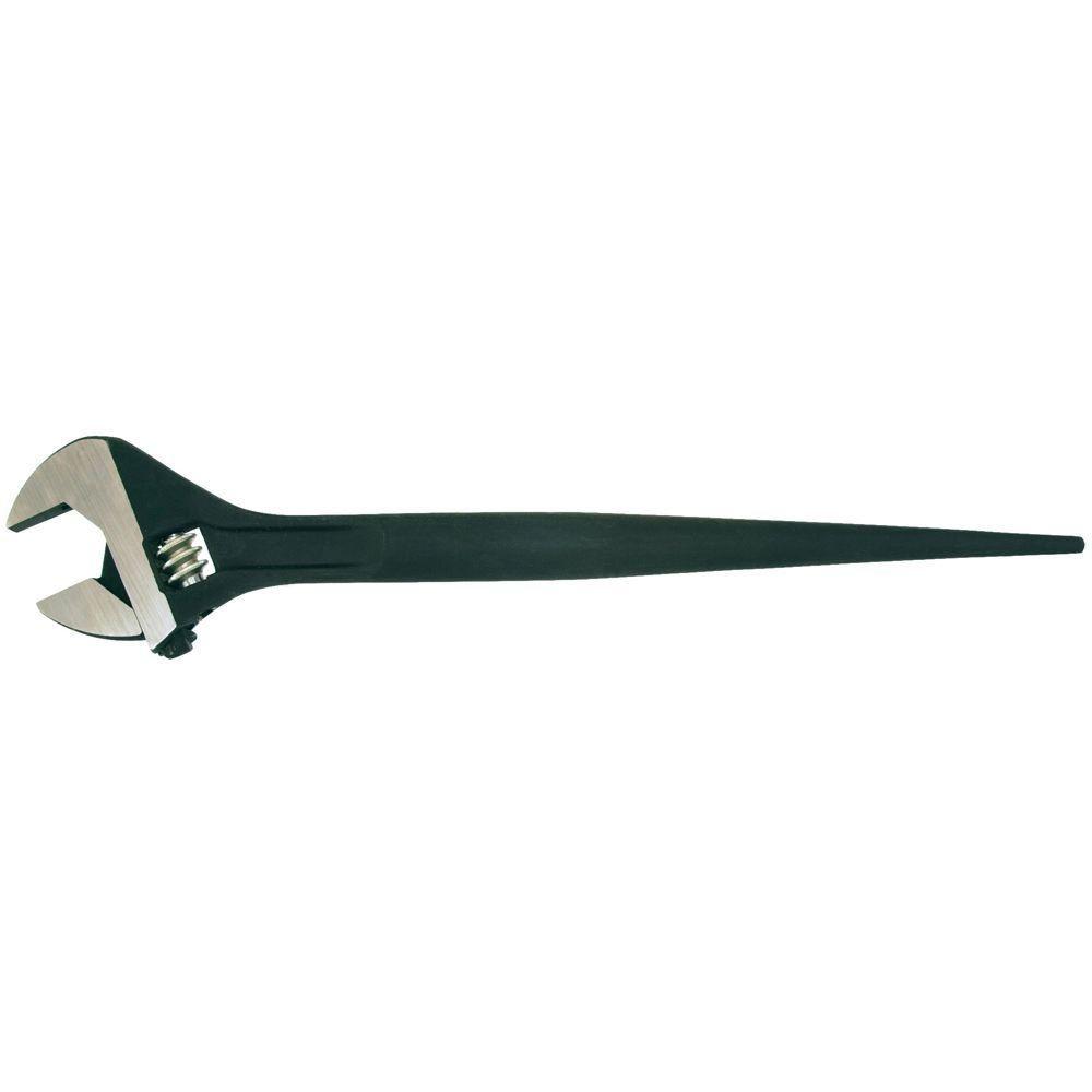

Maybe very CAREFULLY use a come along to help pull the crossmember into place? If you can get at least a small bit of each 3 to line up, like enough to get a steel awl/tapered pin punch or something like a spud wrench handle tip end to work the crossmember, frame and bracket holes to line up better and center everything.
Steel workers use tool pic 3 and 4 to get the bolt holes in 2 separate pieces of metal to line up. It's called a spud wrench.

That's a tool nm am definitely adding to the shop now. But also think I'm just gonna try it without removing the bracket. Its funny yesterday morning before starting the work, I did my weekend garage sale route and got a come along for 2 bucks, not even thinking about the work i was gonna be doing later. Glad i got one. And thanks for that az charter link! Didn't even know about that. Membership pending now, and I even found 2 members in this little middle-o-nowhere town
