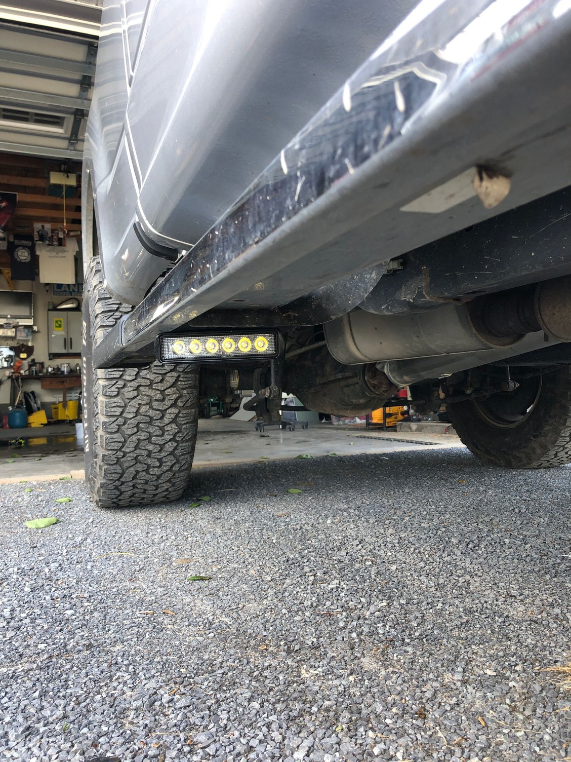

I went ahead and ordered the previously referenced plugs. They'll probably be here in the coming week. Ordered lights at the same time and it looks like they're scheduled for delivery today. We'll see how well they light up the underside as extra puddle lamps.
Amazon Amazon
Old Jun 21, 2019 | 04:38 PM
Poncho450's Avatar
Poncho450
Joined: Oct 2014
Posts: 5,943
Likes: 1,357
From: NY/Canada border
Lights arrived today, plugs not due in for 4 more days. In the meantime I mounted the lights to an existing bolt under the running boards, as I didn't feel like drilling the truck.
They're located in close proximity to the power plugs and with my uses for the truck the lights should have no problems with ground clearance.
