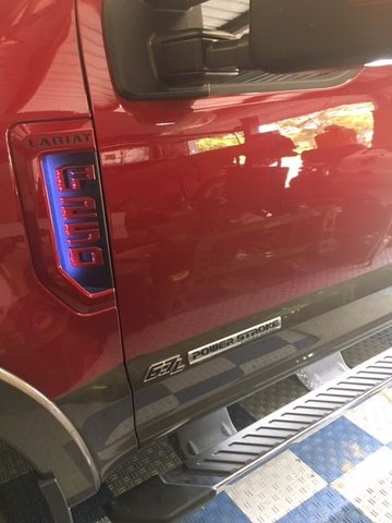

It does take a little messing with to be removed , but I got mine out and wired running board and side badge led's into them .
Do you have a link to your work?
Here is the thread : https://www.ford-trucks.com/forums/1...lor-match.html

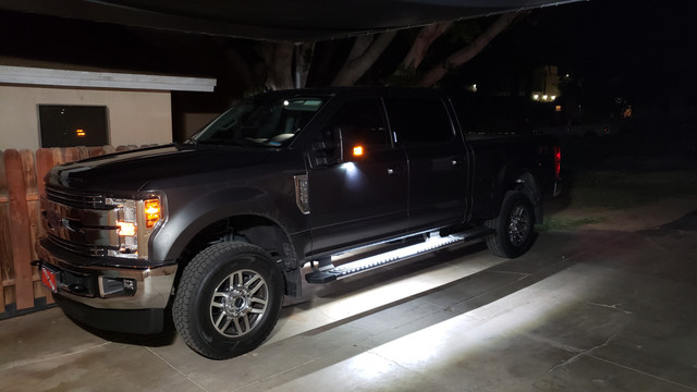

I bought mine on Amazon I think. There is a thread somewhere around here that has links to light and great info.
I love mine.
