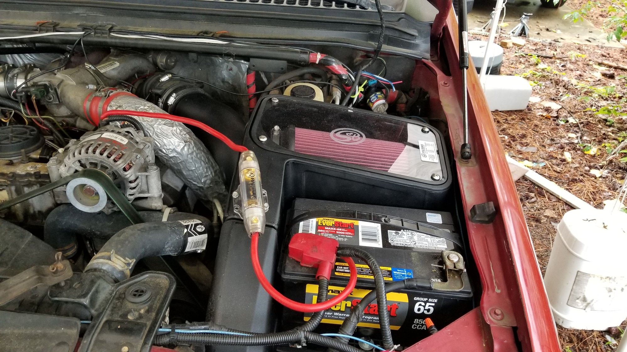

installing new batteries at Walmart.
battery cable to drive side through 200 amp fuse and YES that is a new S&B air filter assembly..
when your truck is running the voltage at battery should read 14.1 to 14.3 if you are less then the alternator could be going bad.. On my 03 the batteries i bought the truck with in '15 were put in the M month of 2011 which is 12/11. I replaced them this spring with two new date code walmart 850 CCA guys. Now the alternator was rebuilt but local company in Va, Beach VA in the past so that could be a lot of the reason they lasted so long. plus during winter I keep a harbor freight trickle charger on it as i don't get a change to drive it much.
When i am at idle the plug in USB which has a volt display show 14.1 and at speed can show 14.3. I also have a separate battery wire from alt to driver side battery as well..
